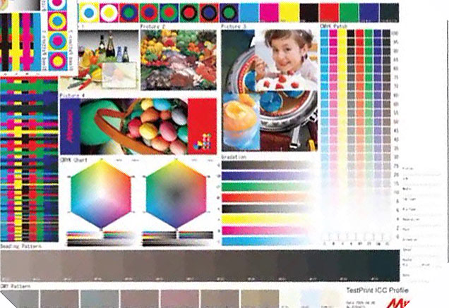

When you print your Mimaki printer control file(s), do they appear to look good? Neutral grays? Not flooded with ink? Etc.
ColorCrest
All around shop helper.

I haven't tried those no, but I'm having trouble with straight CMYK colors, so it's not the sRGB->CMYK management I want to disable. I don't know in how many places the CMYK value is being managed, but I'm thinking Media ICC would be one. There is something that makes a 0 100 100 0 value print pink, but if I force that value in "replace color" to 0 100 100 0 (yes, the very same value) it's printed red. So somewhere along the pipeline it's transforming the 0 100 100 0 to another value which is the whole point with ICC profiles, but in my case, not even a correct profile prints as it should. I'm guessing faulty profiles but haven't got enough resources to buy calibration equipment.

Your post is titled "Bypass/turn off color management?" Take the time to read through your Rasterlink guides to find exactly how to do that. Then print controls files with color management OFF to visually gauge if the printer is close to a calibrated state. (Grays should grays, etc.) Many colors will not be optimized until you actually use the proper ICC output profile along with the proper steps including machine settings.
I suspect your profiles are usable but I further suspect you are having trouble elsewhere in your process.
