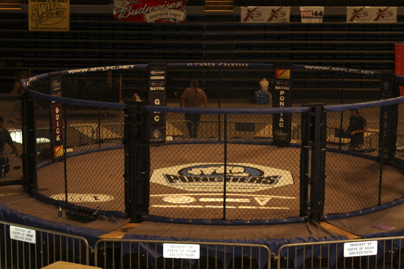

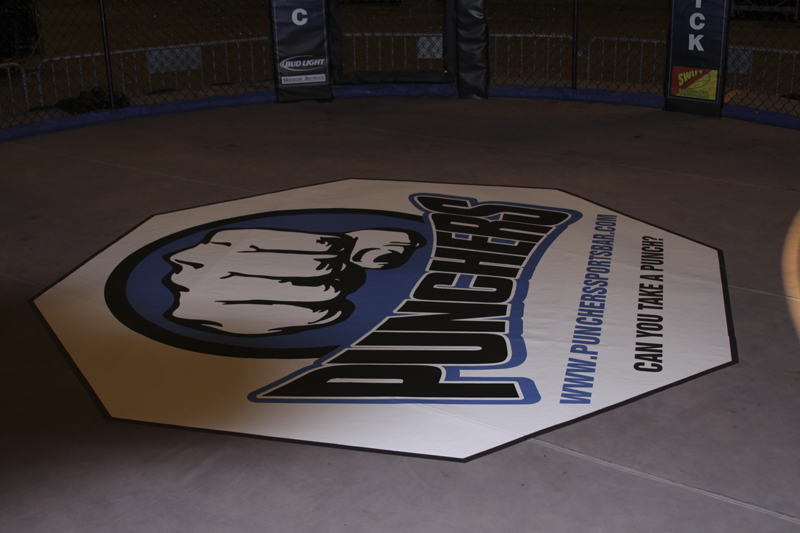

We have done this exact thing... Ill upload a pic in a sec. We printed on a standard printable vinyl, I think it was oracal. We jut used what we had that had the most aggressive adhesive... and then laminated with a matte laminate. We were told by the manufacturer that the non-slip laminate was too think, and would not bend and move with the mat as the fighters moved across it.
x2chris7x
Here are the pics. I believe this was about 8' x 8' and was in 3 pieces.
