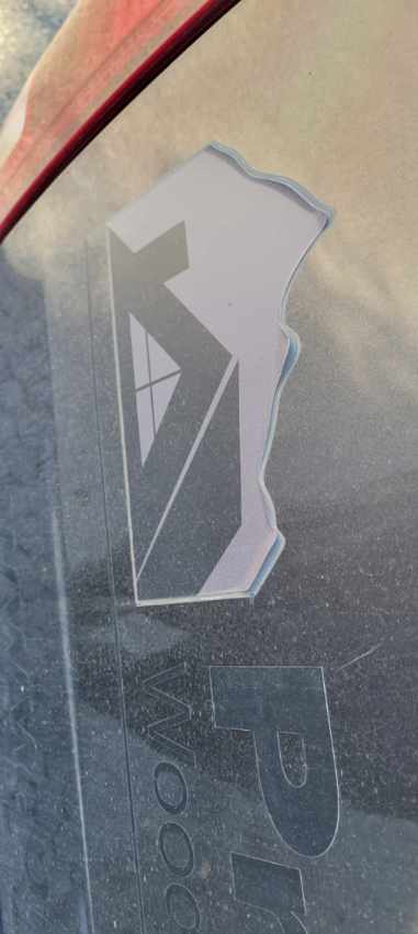

Hello - we need to do a print & cut onto a vehicle grade gloss vinyl which is a calendared product. The client wants this to have a matte finish though. We did this job for them using a printable Hexis vinyl about a year ago, but unfortunately, because both the vinyl and lam were calendared, the decal has shrunk and is starting to lift. We have looked into a variety of options, but these are just a couple small decals we need to replace and don't want to invest in a whole roll of anything right now, as this is something we don't do very often. I was sure I read (at one time... somewhere) that the solution to this might be to cut the calendared matte overlam a bit larger than the decal itself to eliminate this shrinkage issue. Is there anyone out there who has used this method before, and how successful have you been and how much of a bleed would you recommend applying to the cutting of the lam? Again, I don't want to invest in a bunch of material to sit and expire on my shop floor, but I also don't want a repeat of what happened the last time. Note - we are planning to reprint these onto a calendared AUTOMARK - 2.4 ml white gloss and laminate with a Arlon Series 3420 calendared Matte Lam. Thank you all in advance for your advice!

The shrinkage in your picture doesn't look normal, not even for a calendared vinyl, and certainly not for a rather small sticker on an almost flat surface.
How do you apply the laminate?
Is it possible that you stretch the laminate when you apply it, and that it simply shrinks back to "normal" again?

It looks like your problem has more to do with the fact that it is mounted on glass, than with the material. Glass is a problem. Stickers/Decals often don't last a long time on glass. We always warn the customer that stickers on glass probably won't last as long as decals on painted metal. Nobody has complained, and customers seem to accept that explanation.
If you use a cast material or some of the high performance calendared, it's often not sticky enough to adhere to glass properly.
If you use calendared, with a calendared overlaminate, the edges often lift because of shrinkage.
Best bet, in my opinion, is to use any calendared or cast material with a sticky backing and a cast overlaminate. A 30" roll of cast matte shouldn't be too expensive and has a long shelf life.
Also, I recently was instructed that 3M IJ40 is both sticky and high performance, so this might be a good way to go. Actually, we're going to try it on our next inventory cycle.
At any rate, we've had good success with any sticky calendared and a cast overlaminate on glass.

First, using calendared media instead of cast means that you get to save, quite literally, a few cents. Not worth it. Then, after looking at your photo, I've never before seen properly installed laminate lift off the media like this. This would lead one to believe that it wasn't properly installed. I assume that this is just a crappy photo and the gray is really unprinted white and not a full bleed. If the latter then that has a host of problems as well. As for cutting the laminate larger than the decal, it requires two passes through your plotter as well as two weeding sessions and makes for an interesting, to say the least, job. Moreover, why do you expect the laminate to be any sturier than the media?
