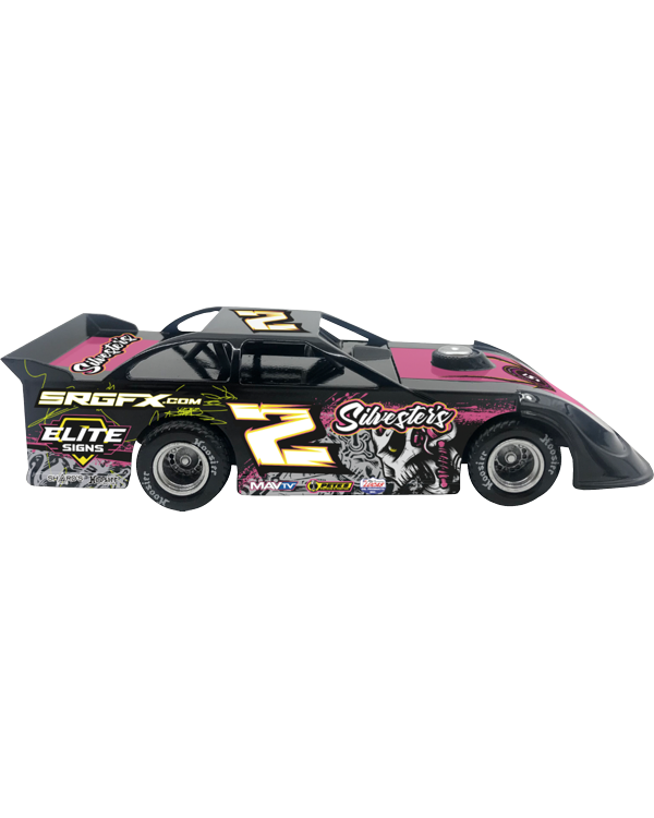

Right now im trying to find someone who can print in fine detail. Like font 1,2,ect
I am doing 1:32 scale race cars. Have a bunch of orders, but everything ive tried comes out too fuzzy.
Any suggestions? Attached is a pic of what other guys prints look like.

Have you actually seen other peoples print though? That pic you have posted is a photoshop mock up, not a photo of an actual race car...

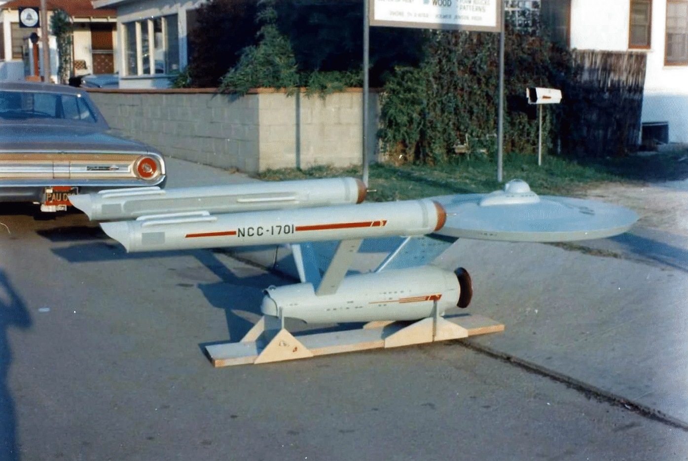

imagine how small the print on the original Enterprise model for Star Trek was.... yet when blown up to fit your screen it looks totally clean. Your Roland set on overlay could not make those graphics. If someone is truly making a scale model and wants the graphics to hold true at the scale, then you need a process that is either optical or if digital, has incredibly high resolution. OP said he was trying to print fine detail on 1:32 scale race cars - the resolution of your Roland does not scale accurately to this size.
