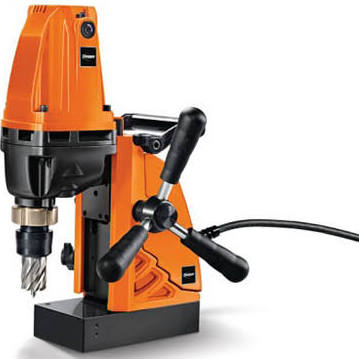

If you want to build this with removable faces, attach them with countersunk machine screws. Drill and tap, then countersink the hole carefully. You don't need too many screws if the faces are .080", .090" or 1/8" aluminum sheet. I had always meant to buy one of those little portable magnetic drill presses for drilling and screw-tapping but never did. A press allows for perfectly perpendicular holes, and you can set a stop for perfect countersinking. For working on an aluminum sign, of course, it may be necessary to clamp a piece of steel to the sign. Yes, it's a luxury item.

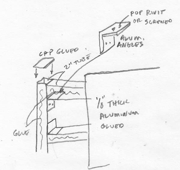

Like brad said but without welding use 2" equal alum angles to match 2" square alum tubing You can screw and glue them and same with 2" cross braces. rough drawing
