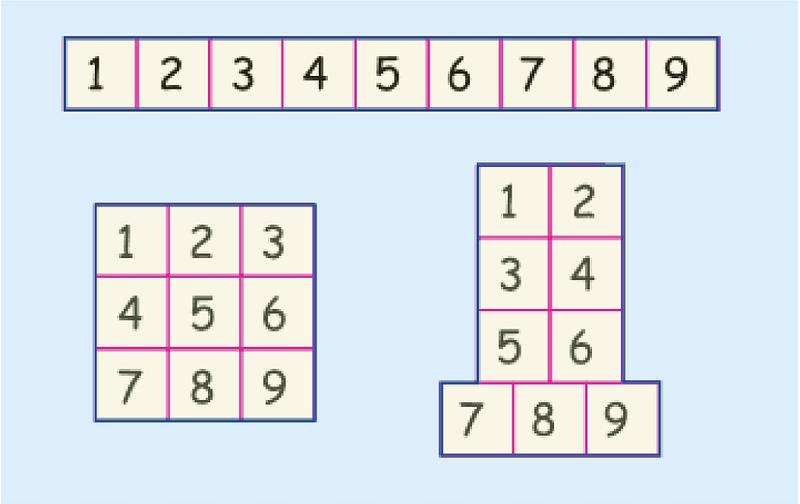

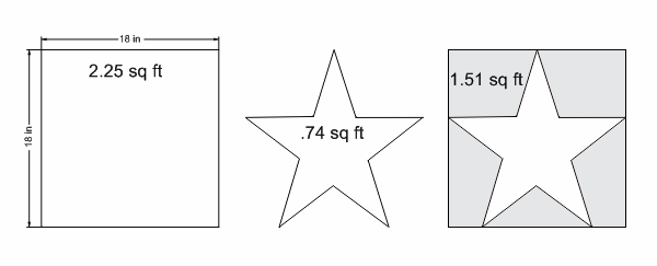

My city bases permit fees on the AREA of the sign. It is $2/sq. ft. (That's another rant for another day.) So a 4' x 8' rectangle sign = $64 for a permit. A 4' x 8 oval = $50.28.
In the attachment, all three of these have the same area. If you use the H x W that some of you are talking about, you'd end up spending 33% more for a permit in my town than if you used the correct area.

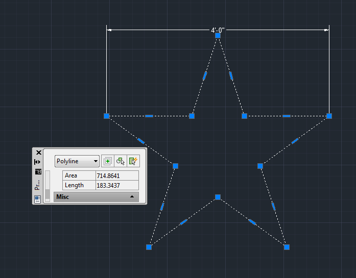

Autocad automatically calculates the area of an object. It also has an area tool that allows you to trace around the objects you want to measure. In this screen capture, the object properties box is showing the area of the selected star (square inches) for a regular 5-point star of 48" width. For a permit, the actual area of 5 sq ft is 1/3 the bounding rectangle area of 15 sq ft!
