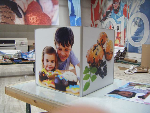

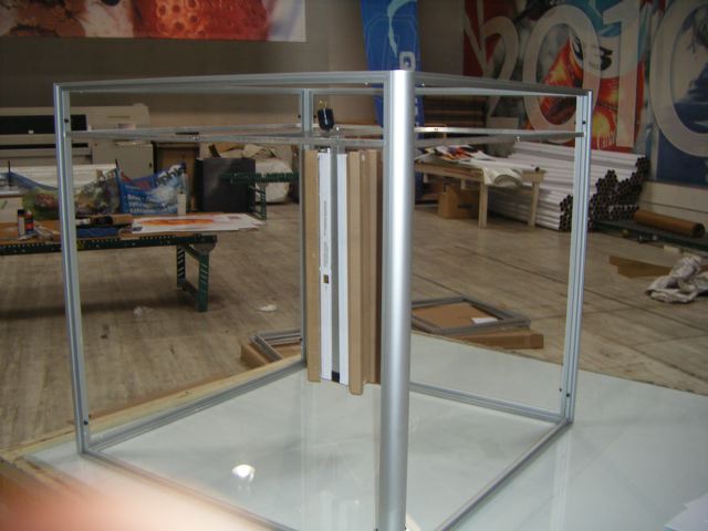

Hi There,
We had 3' x 3' cubes made from an aluminum frame. (Custom made from a metal frame manufacturer that had 1/4" channels in them. The Channels were then fitted with Sintra panels printed on a flatbed printer. ( We put a light difusing acrylic on the bottom and had a light fixture added but that's not necessary.
They are easily taken apart and stored flat for shipping
They looked great!
Good luck,
Patrick
