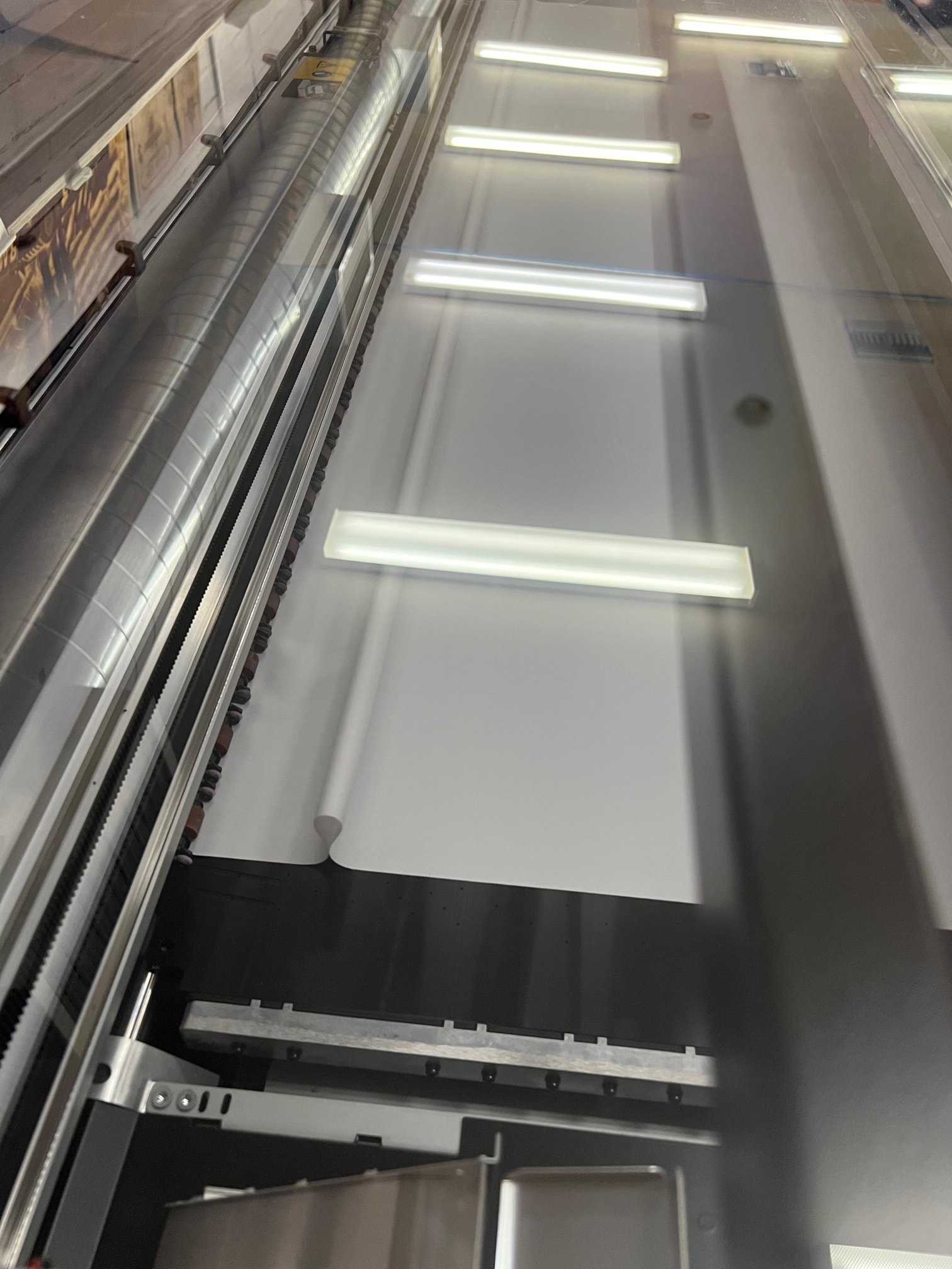

So w have a new Canon Colorado 1650 roll to roll printer. Up til now has worked fairly well. We are just now trying for the 1st time to direct print to Fabric. This was 1 of the selling points for the printer from Canon. We have loaded the most current Canon Profile and are able to get the Fabric loaded. However when we go to print and the Printer advances the Fabric at the start and it wrinkles up? The take up roll has the tension bar on like they said but to me it seams like maybe the take up roll should be turning the whole time so as to not let the fabric get any slack? What are we missing?? Thanks in advance..

Its probably your tension values settings, you can spend alot time before you get the right formula. we using Onyx and you had to set it, in a quickset profile, its probably the same with Caldera. Did you clean the optical sensor for the media detection? But frankly if you bet on this printer to do any kind of canvas or textile, its not the good printer for those type of media, it can help you to do time to time project, but thats it...its more design for paper.

I suspect Squared has the tension bar in the "locked" position, needs to be unlocked so the bar can fall and pull on the fabric.

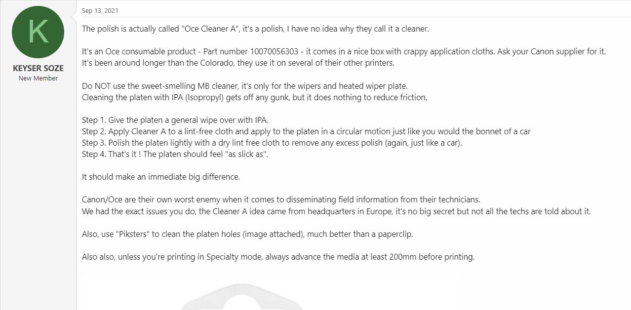

I had a bit of similar bunching (on some materials) when my printer was new and I would pull then media at the start of printing to prevent the bunching. Grab the media on either side and pull down hard as the printer does the first push.
Over time the problem disappeared as the platen got slicker I guess. Make sure the platen is clean, read the following thread, has tips on making the platen slick, I use the "Oce Cleaner A" once per week and it makes a big difference
