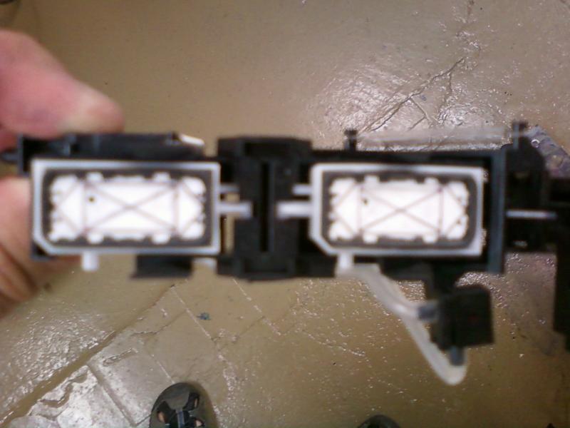

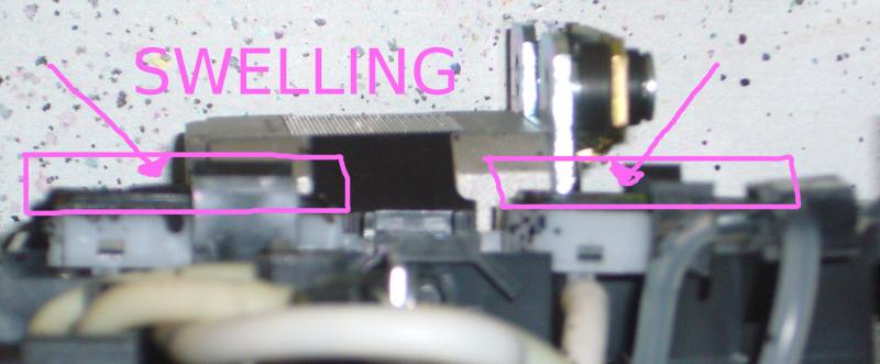

Alright about a month ago my capping station pads swelled up, and I had a chat with fellow signs101 member, Robert M at signagespecialist.com who informed me that the problem was most likely due to the new inks Mutoh started releasing. He informed me that he was receiving orders for capping stations like there was no tomorrow and I in turn bought one, and then proceeded to complain to Mutoh service department, who also sent me a free maintenance assembly array (this is the metal platform that the capping station sits on with pump/tubes/the works).

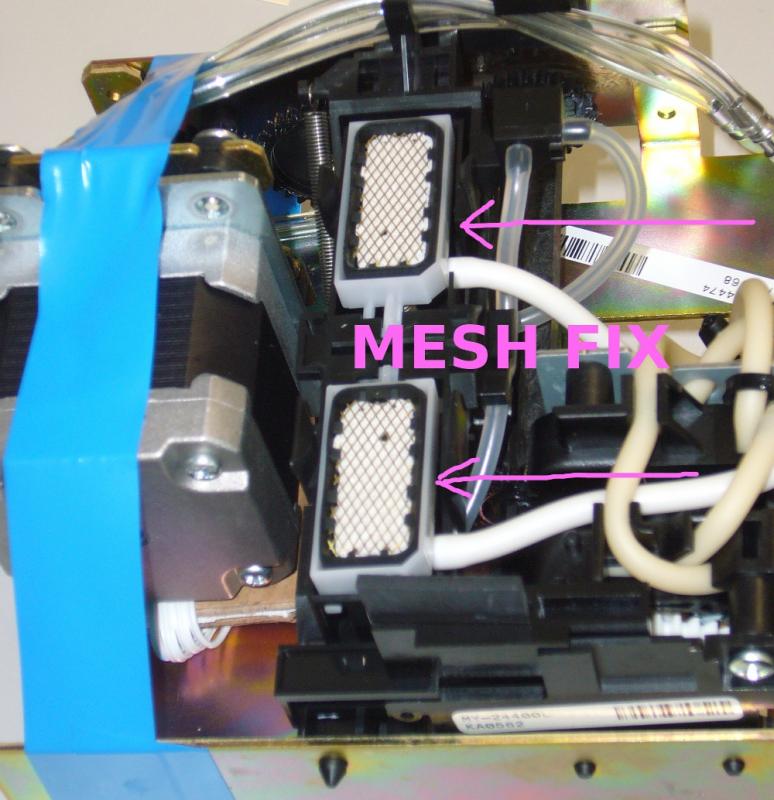

I used the maintenance assembly array that Mutoh sent me and 2 weeks later the capping station pads swelled up again, so I gave them a call. 6 phone conversation, 2 voicemails, and 8 days later, I have in my posession Mutoh's modified capping station with metal mesh over the top of the original pads.
I took some photos for you guys and am going to install it tomorrow.

randya
Mutoh should really be doing a recall but seeing as they aren't, feel free to call their service department in Arizona at 1-800-996-8864 (ext 5) and ask them for their working version.

Caps do swell up over time and are considered a consumable item, why some are reporting a very short time is still unknown to Mutoh.
There can be a lot of factors, in the field, from improper maintenance to improper chemicals used for cleaning to just bad parts.
Apparently, the service depart has been unable to reproduce the swelling of the caps in house, and only a very small percentage of the caps out there are actually having issues, so there is no justification for a recall. But we are concerned that people are having issues.

Apparently they have stopped making the brass mesh that we have been using, and so they are searching for another source.
I suggested that they look up McMaster-Carr.
My understanding is that they take out one pad and leave one pad in and put the mesh over that.

I installed the new capping station with "screen fix" today and have been having trouble getting a good seal on it. Seeing as I only have half a day experience with the new screen I can't judge it too harshly but I have to say that it seems very flimsy, and I don't expect it to hold out for very long if a pad should swell.

I examined some of the capping stations that have been returned as 'problematic', some are obviously more than just weeks or even a few months old. Some of these just need replacement as the consumable parts that they are. Some are new.
The capping station that I'm sending back to Chuck for inspection was 2 weeks old, and it was supplied by Mutoh service dept. I have another capping station here that swelled up in only 3 days with minimal use, but not as bad.
