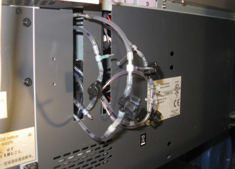

i've got ball valves and inlets hanging out the back of my printer. when i want a head soak to really stay. i have my gf go behind the printer and turn the valve when all the air is bled out of the line, thus leaving nothing but solution. i'm about to install some rc three way fuel valves. they will work much better for the whole retrofit. attached is the current set up. this mod took about 15 minutes to do and i constantly use it to purge, draw ink, monitor pump function, seal off lines, clean lines, diagnose vacuum issues. it is a must have.
