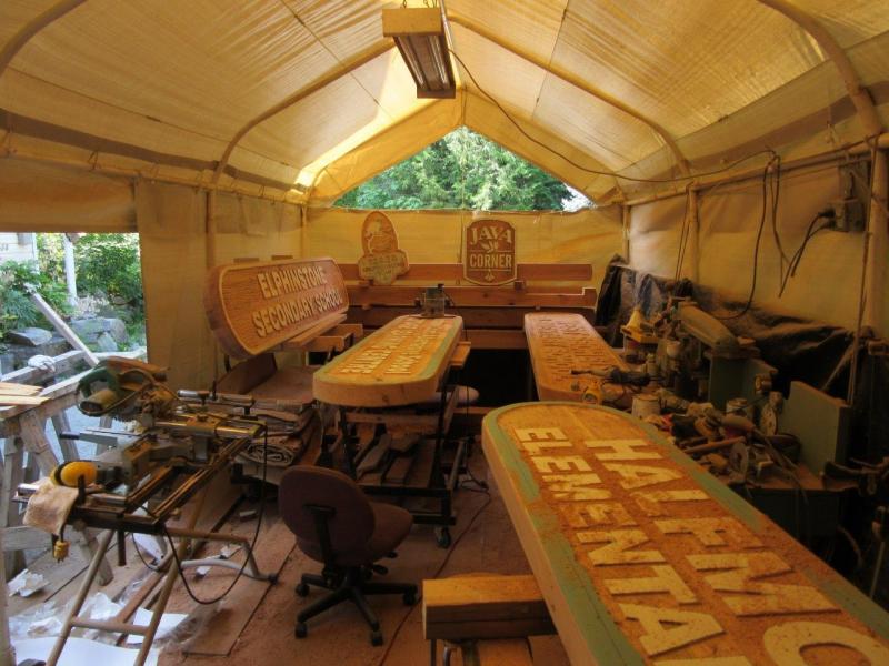

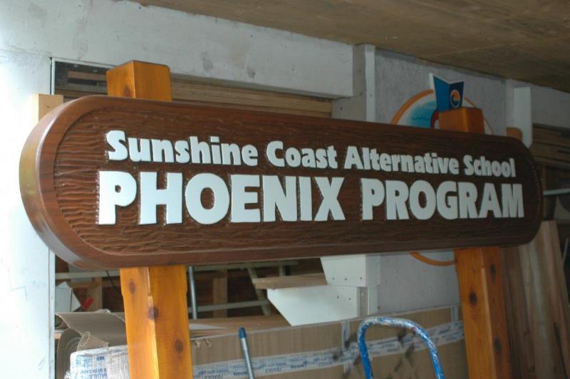

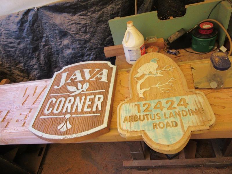

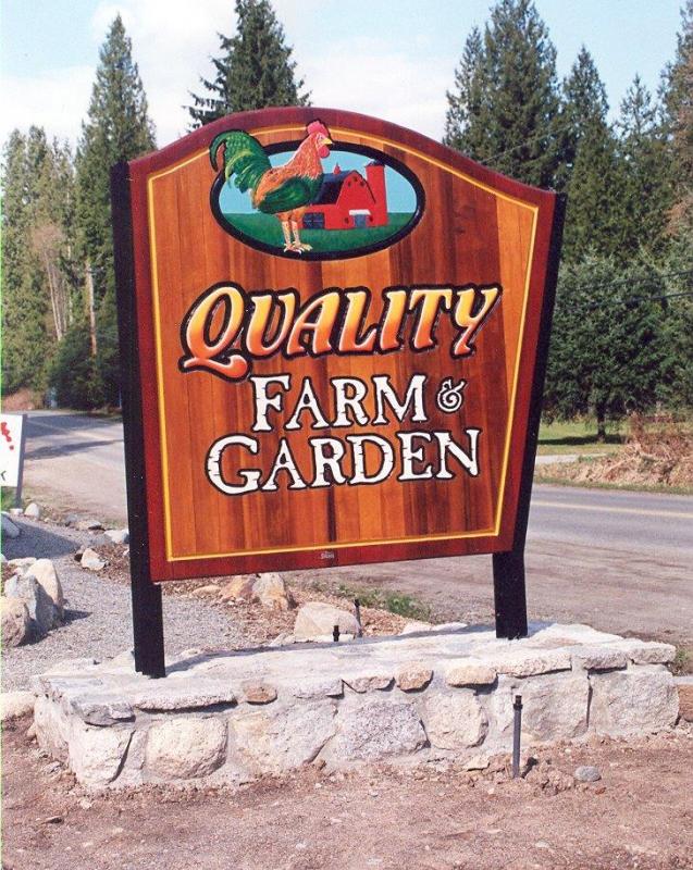

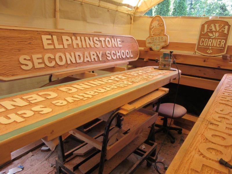

I have been using Sikkens Cetol oil finish for 20 years without any issues. Lettering enamel sticks to it fine. They make a waterbased version and I'm trying it on a few small projects, but the oil based stuff is real good on cedar. Here are a few pics of the signs in my makeshift carving shop right now, and a couple finished ones. If after a few years the finish looks dull, a quick rub with a scotchbrite pad, and then a wipe with a Cetol dipped rag gets 'em looking good again for the next few years.

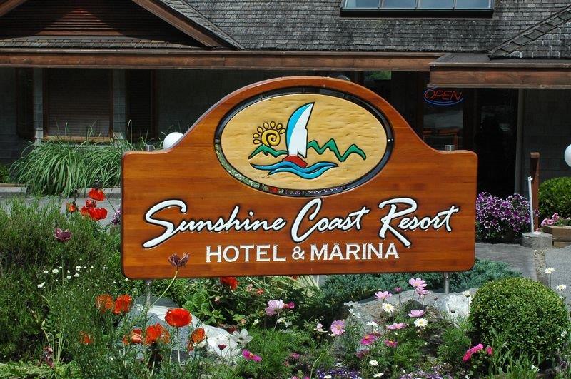

Laserfred - Thanks, the oval insert in that sign is yellow cedar. It's finished with Cetol Marine Clear Topcoat. It's supposed to go overtop of regular cetol for the UV protection, but the client wanted the whiteness of the wood to show. It's been in the weather for 5 years now and some greyish spots are just beginning to appear under the clearcoat. The "logo" was not my design. I only designed the sign itself. The cedar oval is mounted in two flat iron hoops separated by welding some solid stainless 1" bars between them.

I have a lot of different routers and die-grinders that I use. I used to blast 'em a lot and I still do some that way. I'm home based on a couple acres and I have a hillbilly blast booth and a big diesel compressor. The large school signs mount hip height in school yards so they need to be more durable than the venetian blind effect I get from the blaster. Kids are gonna climb on these and rub the faces with sneakers. I route the background down with a hand held router, then go at 'em with a die grinder holding a small ball rasp. Sorta gives 'em a driftwood, weathered texture. I have quite a bit of fun this way and I don't have to suit up the way I do to blast.
I try to follow the grain somewhat but it crosses over and creates wild grain patterns when the Cetol hits it.
