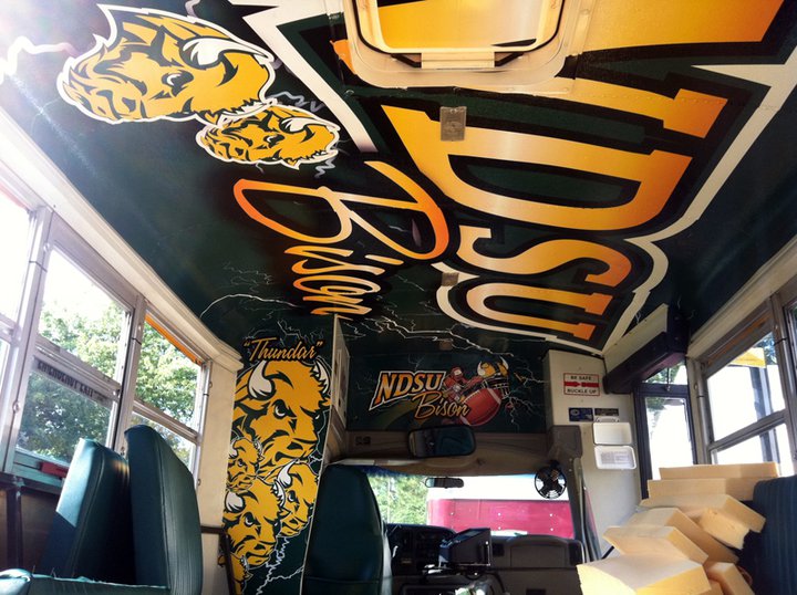

Ceiling suck. I did this bus and just the gravity issue alone was enough to make me not want to do it again and this one I could reach without scaffolding, etc... Good luck.
As far as material I would guess the most important thing is what the ceiling is. Flat, textured, etc...
How about actually cutting panels of wood OR another material, wrapping it in your shop and then hanging at the site? That's my next ceiling plan.

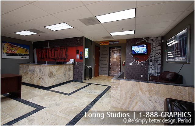

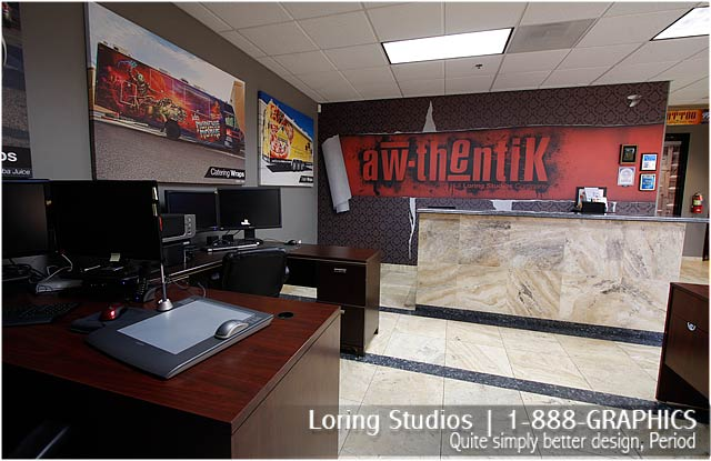

Phototex = awesomeness
We have it everywhere. Plus- it won't damage any surface upon removal
Note: sorry for the image tags- grabbed these samples off of my cell phone from our website.

Been up about 2 years- no lifting or fading. Textured walls with paint. Prepped by wiping all walls with a hot damp cloth and air dry for 30 mins pre-install.
FYI, you can lift an move phototex anytime you want and it retains stickiness. I have one corner of the wall that I've lifted to show clients it doesn't hurt the drywall over 100 times and it still sticks perfect.
