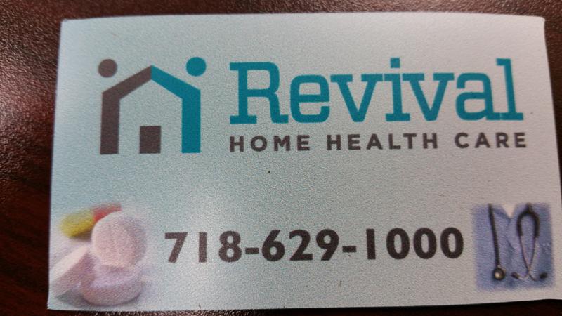

We had a Gen4 CET with many issues. After 1.5 years of issues and arguing the machine was replaced with a Gen5. I had to fight and eventually just sent a PO to upgrade it to be comparable speed to my old Gen4. You would think they replace you with comparable but no. They told me to run it faster and the timing will be same, problem was on solid colors, banding....
As well it is a much rougher print. They claim to get G7 color, on smaller prints you will notice a grainyness and I want better and smoother I need a custom profile and they will chip in with me to build it. Didnt need any of this for my Gen 4. The files printed better on my Gen4 . Coming to a head as I am having returned orders! See attached photo from a clean file. No way it should be so grainy on a well calibrated machine. (and its a re-order so the file is good)
Wondering what others who have a Gen5 have to say.

Is this the true flatbed or the hybrid?
What print settings are you running when you ran the above image?
What material is that printed on?
We just got our q500 Hybrid in december and havent had much for issues, we can print fine print down to about 5pt. with no issues.
In Print
We have a true flatbed and we didnt have this issue with our old machine.
600x900 running .33 screen and 1.0x on magnetic vinyl.

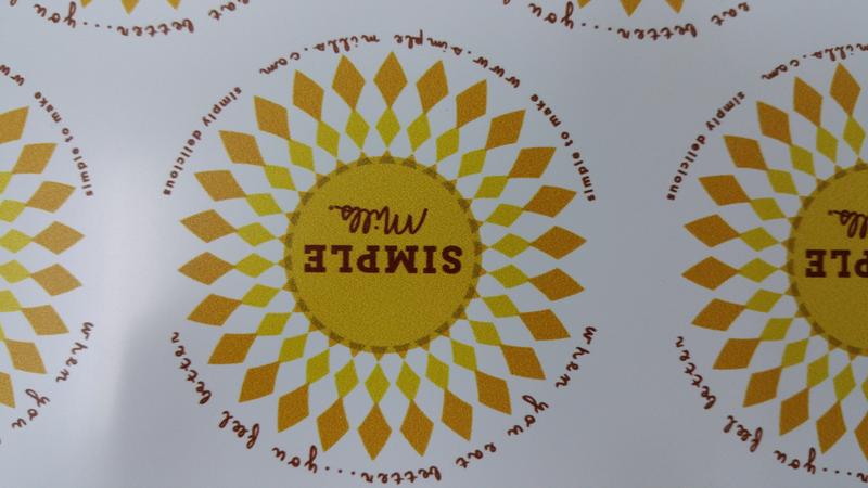

Here is another print from this morning. should be a solid yellow. but to the naked eye the coloring is seen.

I am going to be watching this thread because we are looking into a new flatbed, and CET is one of the top printers on my list.
It looks to me like a profile issue. Is there any way you can print with color management off?
In Print
Chris, Actually I dont know but CET hasn't suggested that. They say it is profile as well. but according to them my files would work in Atlanta because they made a perfect profile.
I guess the CET was made to run only under circumstances that mimic their office. Funny we didnt have that on our Gen 4.

The person who printed these from this post had a slightly better result. Still had the visible grainyness but not as bad. Seems like on a gradient if you bump it up to .5x it helps a drop?
Dont think this is a long term solution but it might help us get going a drop.

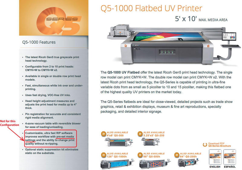

We just got an $180k CET flatbed. It has only ONE material profile called "VINYL". Our old gerber CAT-UV had about 20+ material profiles (eg: coroplast, vinyl, plex, magnetic) and about 6 pre-designed print modes (eg: quality 1, quality 2, Production 1, Production 2 etc). So, you picked the print mode and material profile and it was all set-up.
The CET web site indicates that they offer many (or at least more than one) material profiles. They say the issue making profiles is because there are too many machine variations (head configurations/ Lamp types) and they are kind of flippant with their response (I was told, "if you have a problem with the claims on the site, contact your sales rep"). Well, my sales rep at Advantage Sign Supply has nothing to do with the information posted at cetcolor.com so I'm not sure why they deflect simple questions like that and/or tell the others "make your own profiles" when they claim to have some variety of them included with the printer (*see attached image).
The installer felt like CET skimped on profiles for liability reasons. Like, we'd go after them if the profile didn't produce accurate color results. I feel like not-offering them is a liability. I don't care if the profiles make reproducing colors 100% accurate. I just want a closer starting point. Also, from my understanding material profiles can be about more than just color accuracy. They could also change settings to help promote adhesion... like one could set a slower carriage speed for materials that benefit from slightly longer UV cure times. I know profiles are time consuming and expensive to make, so why put that burden on all of your potential customers?

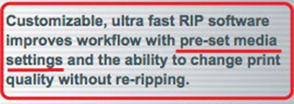

ONYX makes media profiles for CET printers!? They didn't provide them for our previous flatbed (that also used ONYX). I wouldn't think they'd make profiles for any specific machine. That isn't their job. They'd have to own a version of every machine on the market for testing. I figured that getting the CET would be like our experience with the Gerber CAT-UV. In that case, the service technician installed ONYX and then pulled out a DVD provided by Gerber and imported all of the various media profiles for the flatbed into ONYX. Before he did that, ONYX was bare bones ...generic. CET leaves it bare bones ...generic and tells customers "make your own".
The CET site says "pre-set media settings" (note plural in settings). Ok, where are they? Where is the one for coro? We have jus one and it is for vinyl.
