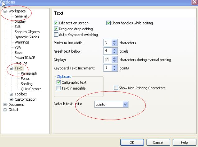

Would someone know how to change from point to inch setting on the font size list? I have looked in options etc. but nothing is obvious to me.
Perks
signmeup
Go to text, edit text, click options, at the bottom of the pop up window it says "default text units"
SignManiac
Under options, click on workspace, then Text and at the bottom to your right
Another thing to remember. When you change your options, be sure to save those settings. Under tools, third option down, save settings as default. I always save a backup copy of my .xslt file to my desktop so if I ever have to reinstall corel again for any reason, I can simply import my personal settings.
