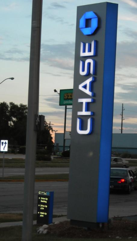

just got a call that one of the new monument signs from a recently installed Chase signage package was vandalized. Going up there with an arsenal of thinners, cleaners, and sanding pads but wanted to see if anyone had any tricks to getting spraypaint off acrylic/plexiglass without burning the substrate. I'm sure my painter will weigh in on this, as well, but I have yet to discuss this with him.
also, I know there's anti-graffiti clearcoats available but I've never used it on plexi/acrylic before... worthwhile? or just keep stacking service tickets whenever these 'hooligans keep comin' back?
will post pics and notes of my outcome.
(noted, picture does not show the damage, just more of a reference to the signage on topic)
