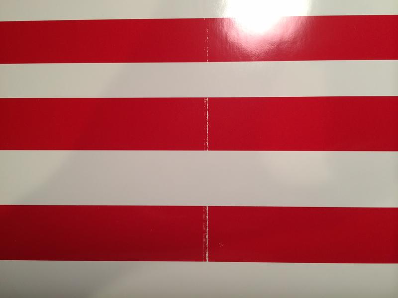

artofacks1
Happens on the first 6" every print. :(

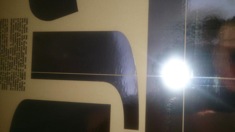

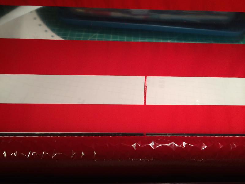

Jburns
Maybe your Silver medal is more susceptible to the print head settings or debris. I had the smallest hair , debris item stuck on my print head I could BARELY see it! had to use my high power flashlight, and made my foil and print look like this.
Soaked with 99% Isopropyl alcohol- and finally got it off.
