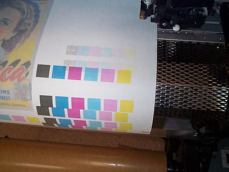

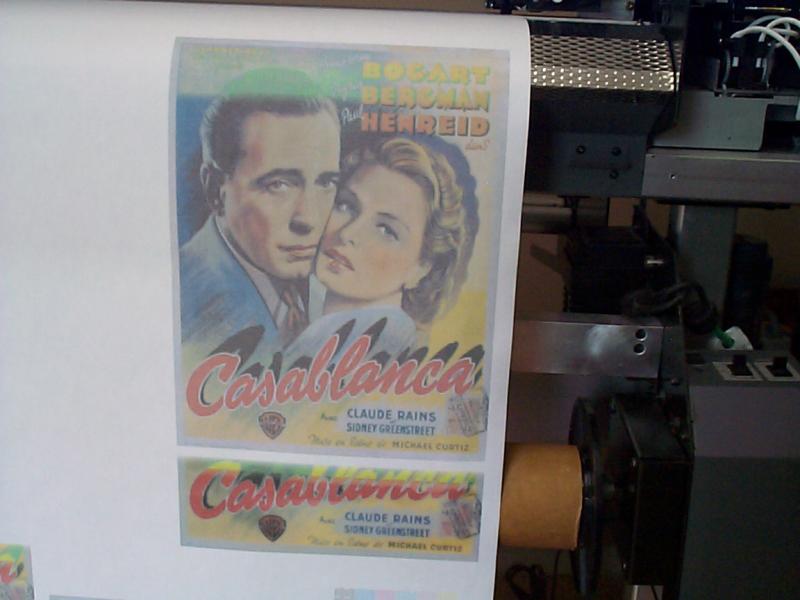

My CJ-500 stops printing the color magenta during printing proses. I installed a new damper, capping station, it seems the print head still have some life left in it by not showing too much issue in the print test...See attached pictures it was printed just on poster paper an 360 res...at a higher res. it runs out of red even quicker. Thanks for your help..

Do a fill test print from the service menu. This is the one that prints an inch of solid fill the length you have media set up. Most times about 24 to 30 inches wide is enough to discharge the ink from the heads and then do a reg test print to see what heads are missing or to find out which heads are not recharging. Its hard to tell in a print which heads are not recharging due to how much of each color you need for that print.
You may find that more than one are not recharging.

I installed new dampers again, also flushed the printhead. It prints just fine the test print..
The test print may be fine, but if there is slight damage to an o-ring, air will begin being introduced after a bit of printing...hence a drop-out even with a solid nozzle/test...
I would do 10" blocks of solid color CMYK's to see if one specifically drops out after some ink usage...and then check that ink train for issues
