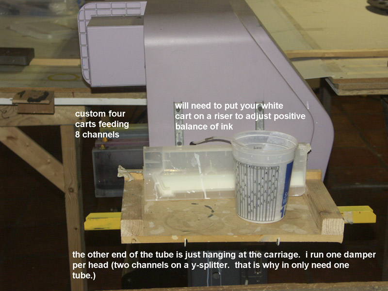

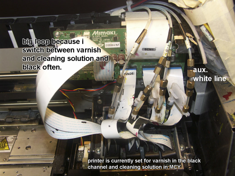

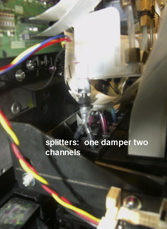

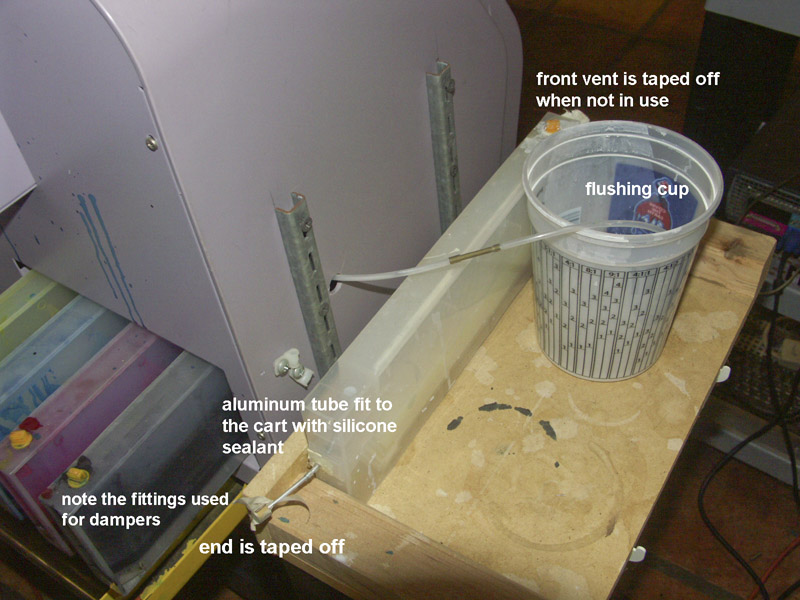

here's some photos of the white cartridge set up. i also included some carriage shots. don't mind all the customizations to the carriage. just giving you a detail of my kit.
your printer would need one white ink cart and then split the line to the two channels (K) a the dx5 dampers. the whole set up could be accomplished in a few hours.
one advantage to this set up is you can shake the white cart' until you see all the settled white pigment become suspended. this cart sometimes sit on this shelf for two months. then i shake it up and print white ink for 10 hours on petg, wood veneer, aluminum.... then take the whole thing down.
even if you did convert your printer to CMYKlclmWW, having white ink sitting in your printer is a bad idea. it settles in the lines, the cleaning cycles in the firmware are much more frequent. it's a disaster. don't do it. if you want white ink, this is the far better solution.
