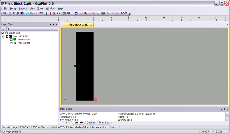

I have never, in 18 years of running an Edge, cleaned the vinyl to be printed in any way beyond what Marlene suggested. If the vinyl has accumulated any dust or contamination from sitting on the rack unused for too long, the most simple and cost effective approach is to start printing after the first turn of the film on the roll. If you are getting dropouts and pinholes on your first print after turning the Edge on, try printing a solid block about 11.8" x 3" before you print your first job. Doing this will heat up the print head evenly and works well.
