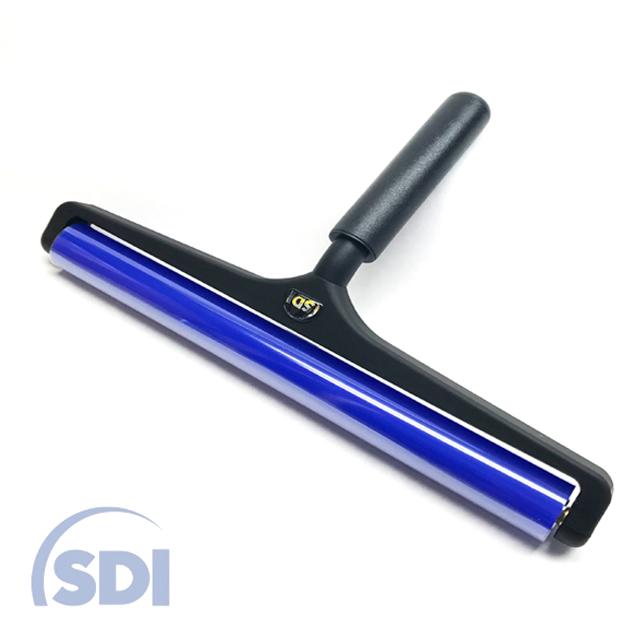

Dust removing roller works well for me. Also use isopropyl alcohol for better adhesion.
