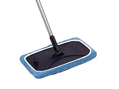

I also have a home made microfiber mop with a wire going from the inside of the mop head, up the handle, and the wire attached to the ground of a plug
and plugged into a receptacle... works great for coroplast.
