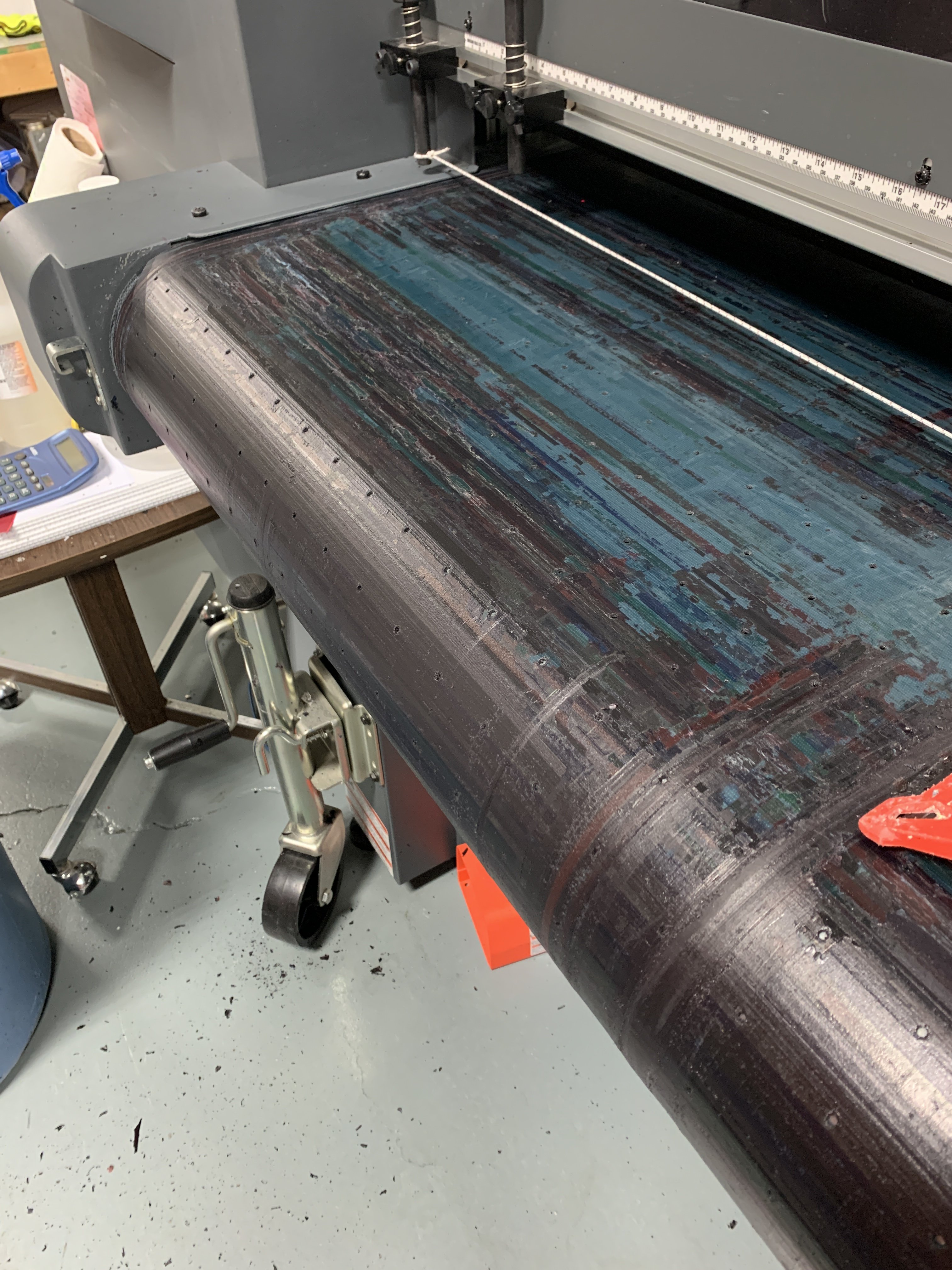

Need help cleaning off years of built up ink on HP Scitex FB700. I'm soaking it with alcohol and using high tac vinyl to take it off. It's very time consuming to only clean a small section. I am a fairly new employee, and I'm already having trouble printing .04 Styrene.

Would something like aircraft stripper on a rag work without damaging the belt? I would be careful to not let it get down in the holes.
You'd be better off replacing it. I've never seen one in that sad of shape.

Jburton has a good point. Maybe the guy thinks it'll take an hour and after spending all day on it, you will end up on the poo poo list. It's pretty annoying when an employee spends more time fixing something than what it costs to replace.

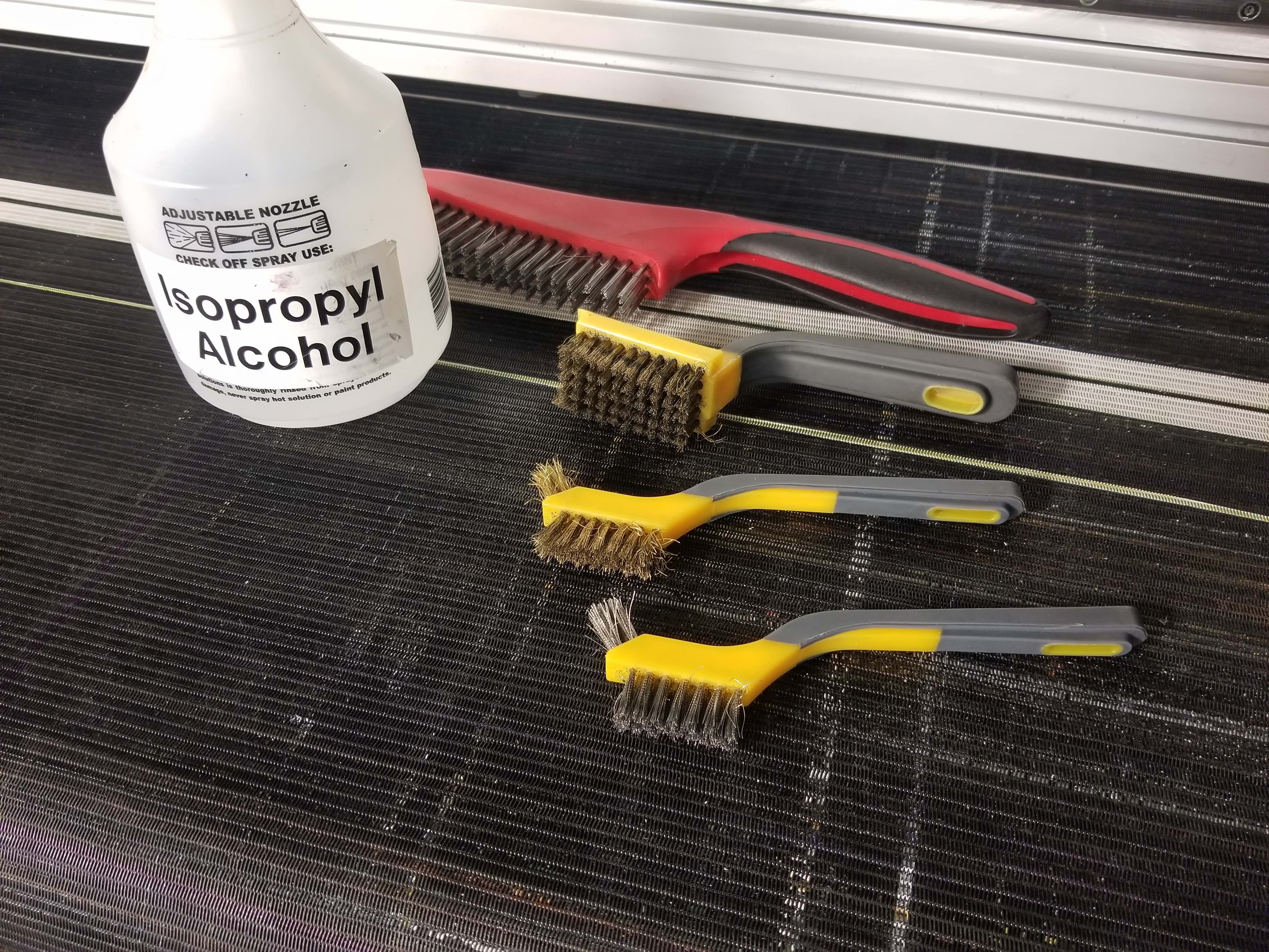

I agree with Gino. I'm not sure how the vacuum has been holding any media down with that much ink on it.
If you can't replace it and must clean, I suggest spraying 99% ISO, letting it soak in, then use a plastic razor blade and wire brushes. Shop vac the *hit out of it and hope for the best.

You need to be SUPER careful not to damage the belt. I have been told that replacing the belt on an FB700 (which is the same flatbed we run) is over $30k. The only people who can do it are HP techs, they are on site for multiple days, and pretty much the whole machine needs to be taken apart. The tech who installed my machine (former HP employee for 20+ years) said he had only heard of it being done a few times because it was so expensive and not worth the money on machines that weren't close to brand new. FWIW, I am not an HP tech and have never had it quoted so I don't know this for fact, just passing along what I have been told.
He told us alcohol and packing tape worked best. As others have said, I don't know if I have ever seen a belt with that much build up so not sure if that will work.

I'm new to this company, not new to signs and printing. Cleaning it periodically seems to be working with soaking alcohol and high tac vinyl. I don't have a deadline, so i'll just keep at it and see if it helps print quality at all.

That has helped alot! Thank you for your suggestions!!
