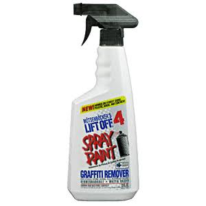

If its a small area - I usually just take a utility blade at a low angle and scrape it off with vacuum in reverse so its blowing out and won't suck the ink down into the air ports.
You can also use graffiti remover from Lowe's.
Its called Motsenbocker's Lift Off 4 Remover for Spray Paint Graffiti (see attached image)
Spray it on and wait til ink bubbles up like stripping paint and then just wipe off.
Test on your bed first to make sure it doesn't react with any coating that may be on the bed first.
