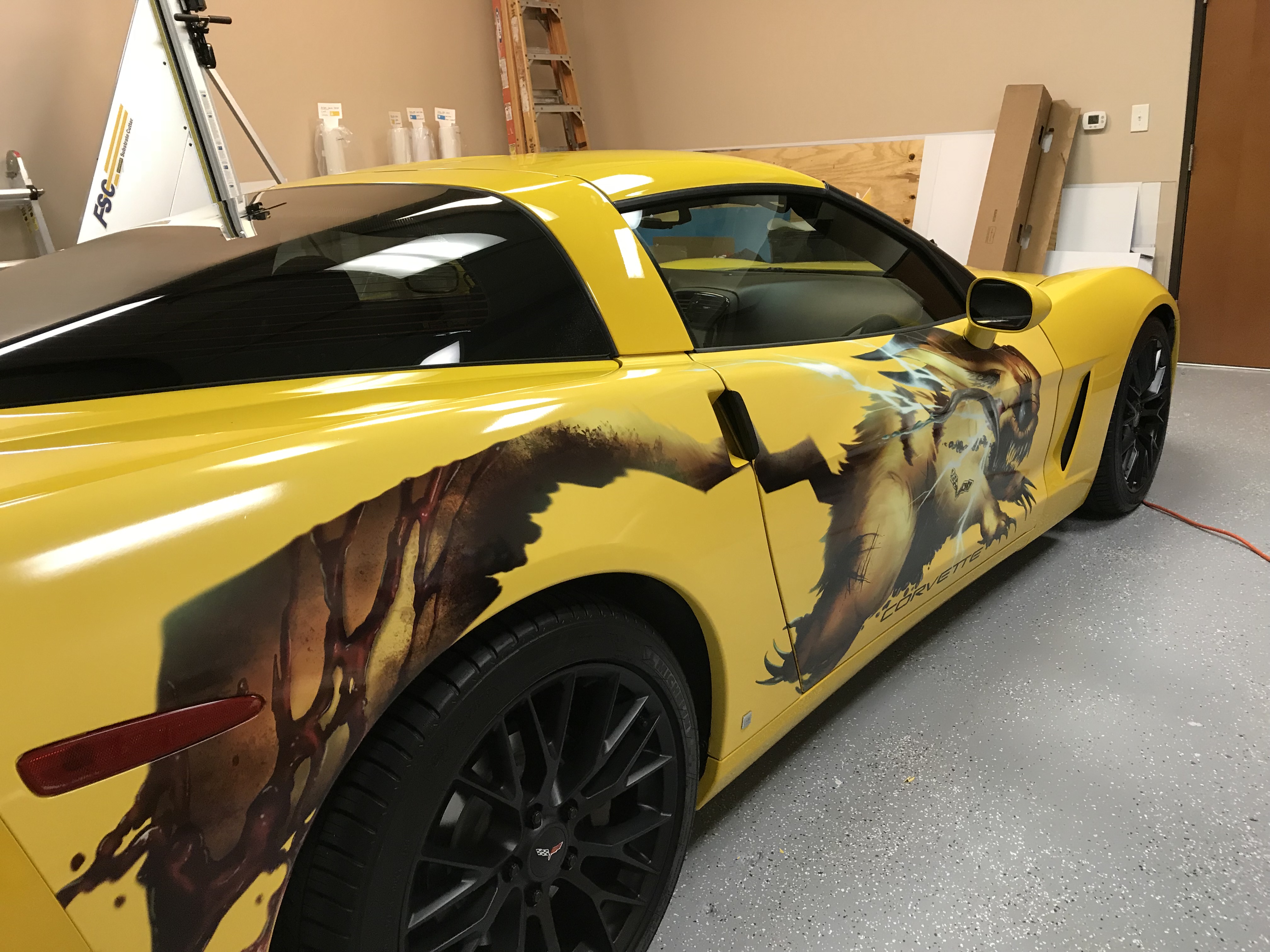

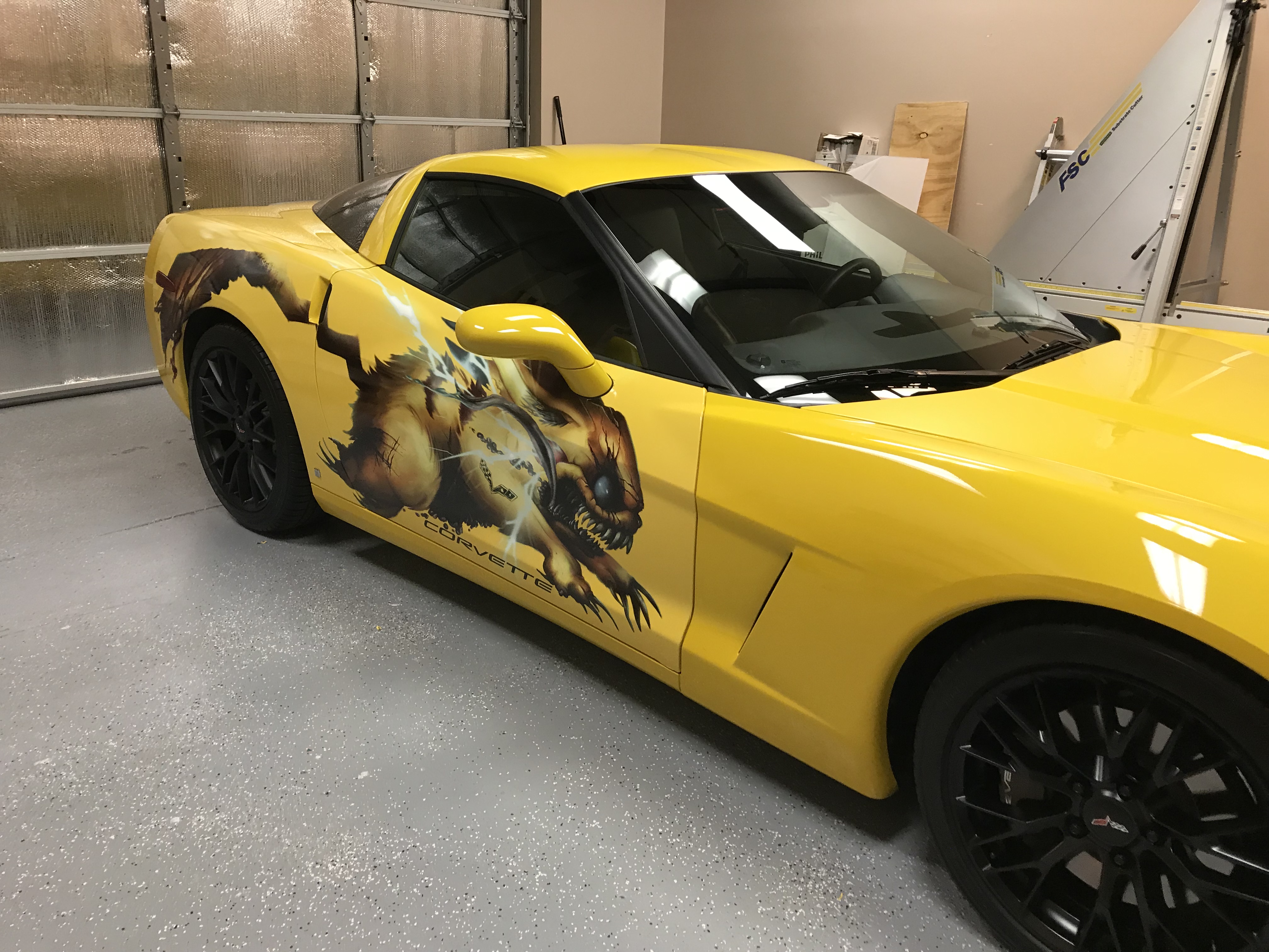

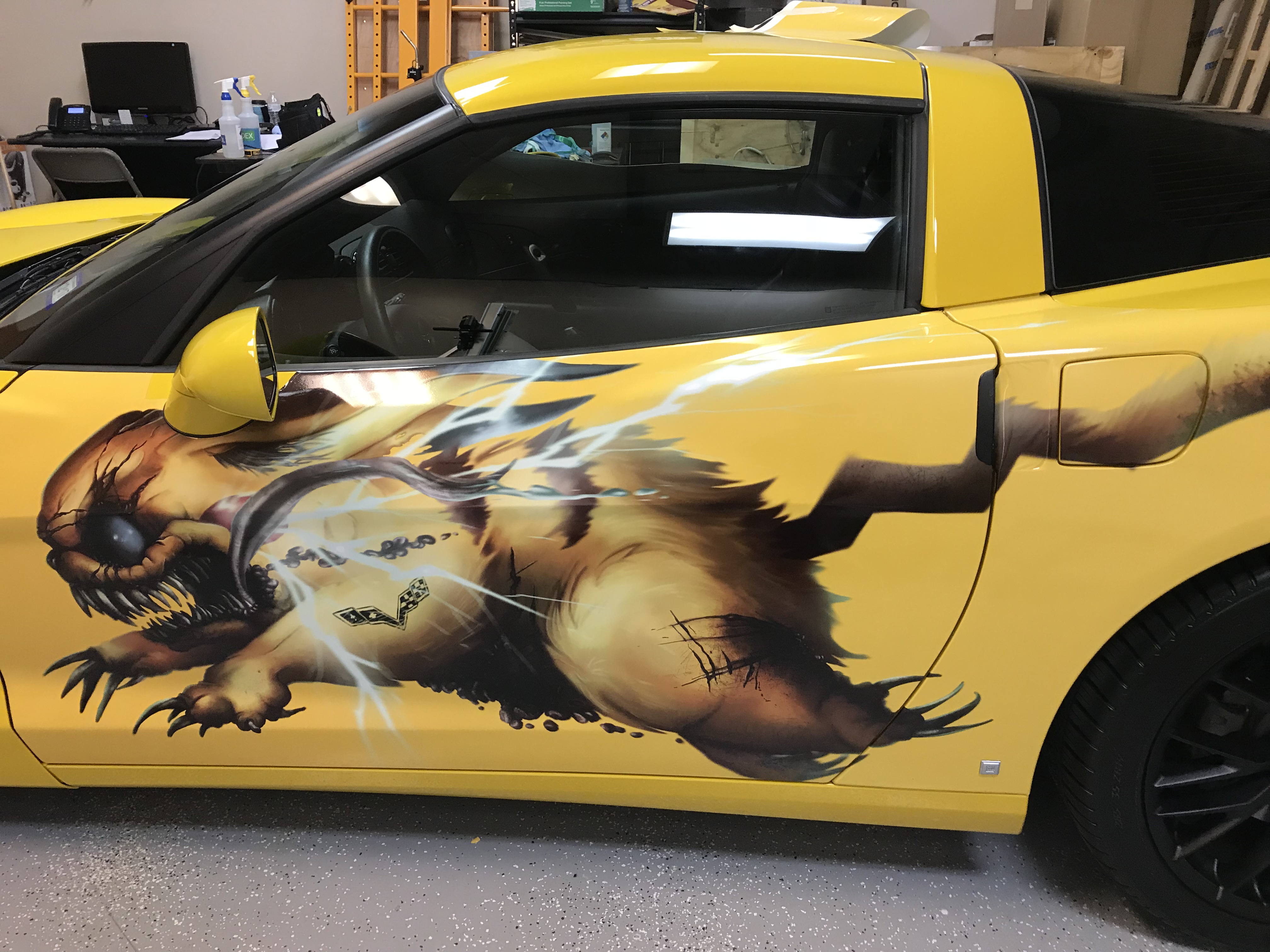

Update:
Ended up color matching and just printing on reg wrap vinyl NOT clear. Also, I know that the yellow color match is not perfect but the customer insisted that it was best match
AKwrapguy
Update:
Why not just do a pillow cut or a bleed cut to shape, Would this not have worked better and this way you wouldn't have had to worry about the color match?
