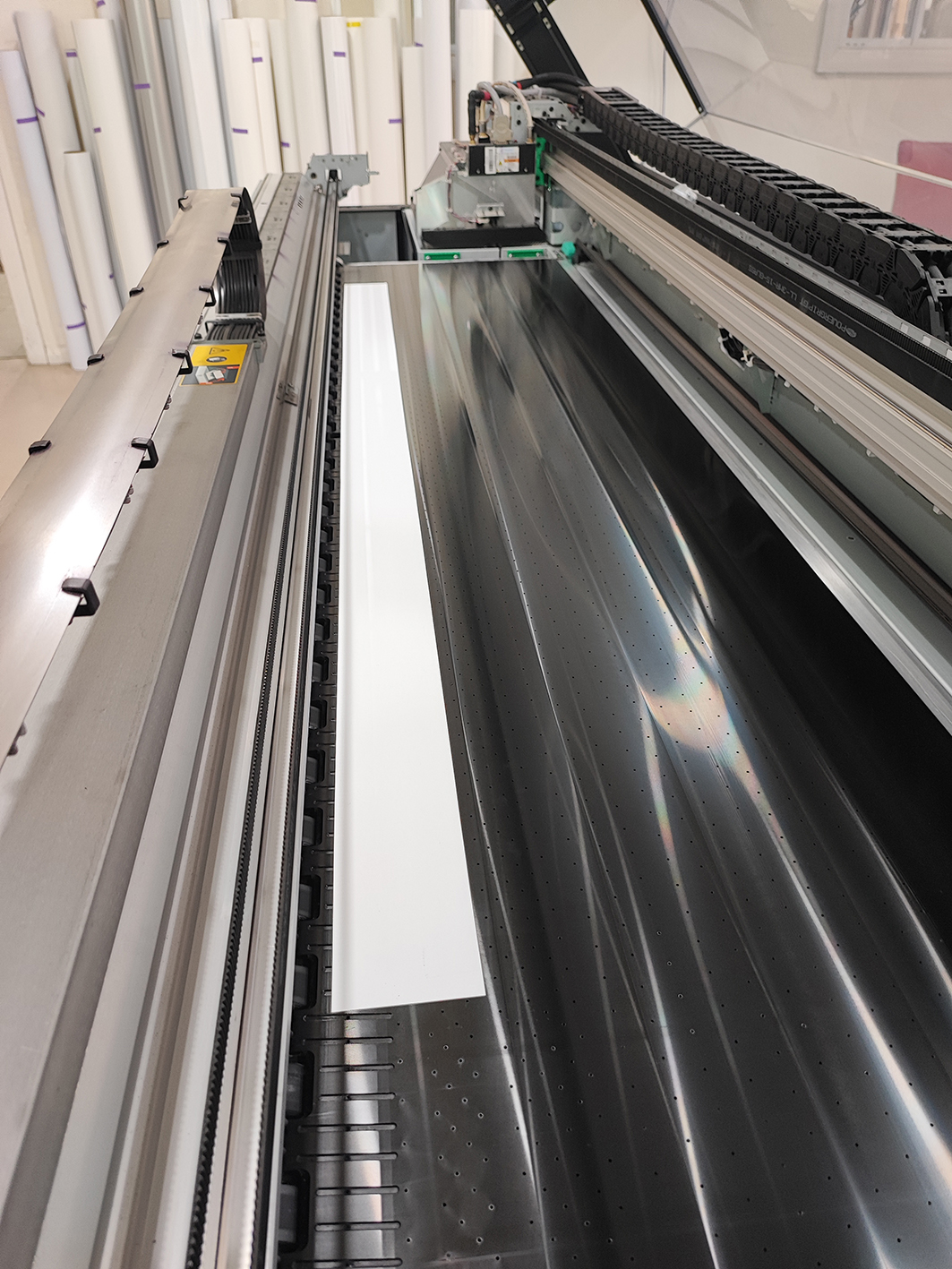

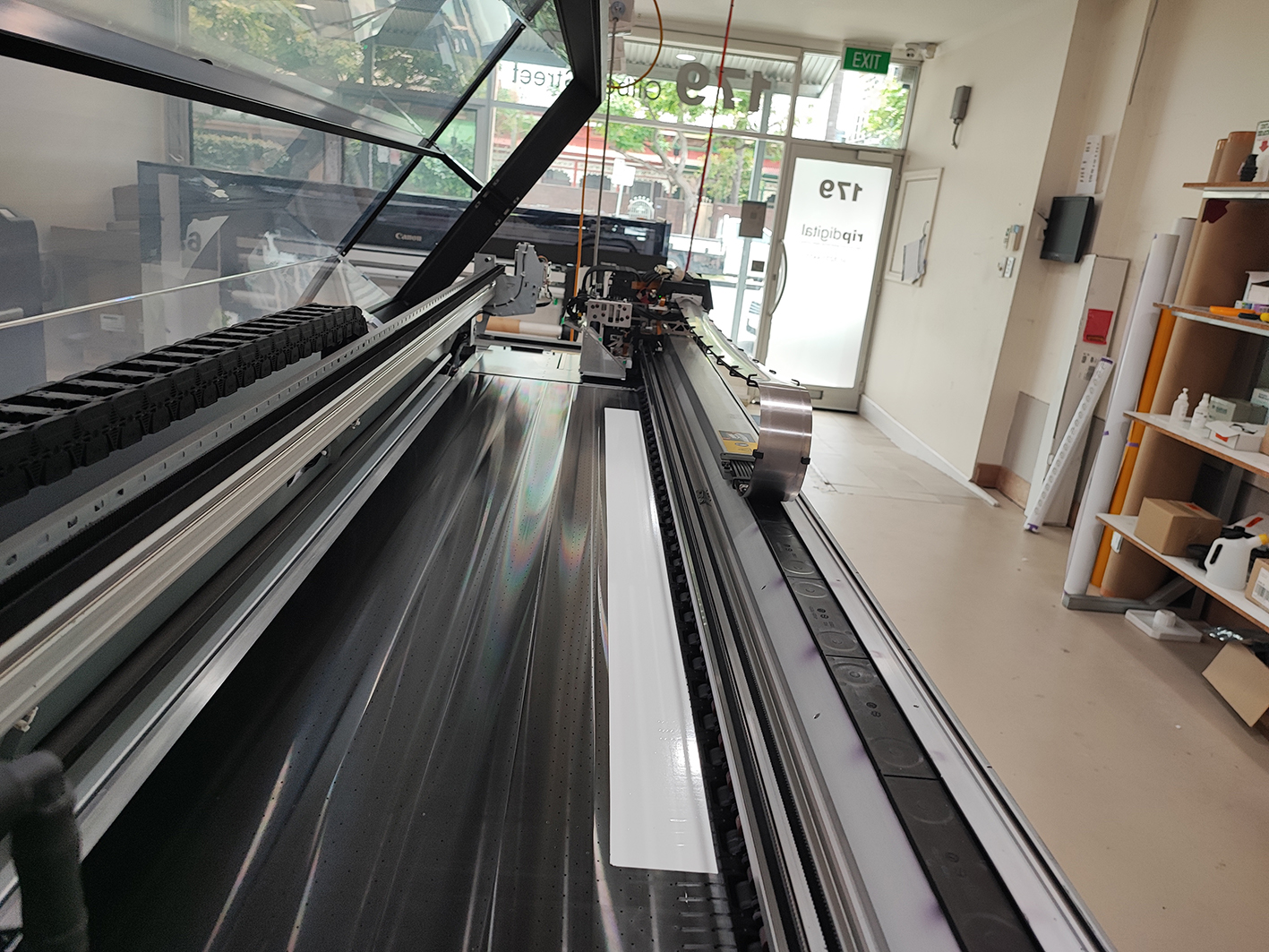

There certainly is a way Mr Square.
Cut off a 50mm wide strip from the end of a roll of CAST WHITE AIR-RELEASE vinyl the same width as the roll of optically clear you are printing on.
3M IJ180 works best, it's thin, tacky, and easy to remove when you're done.
Make it nice and neat, and make a few of them for future use while you're at it.
Press Feed on the control panel with any roll of white media the same width as your clear.
Once it's visible open the cover and put texta marks on the platen each side of the media.
Close the cover and press Retract on the white media.
Open the cover and carefully stick your strip of white cast vinyl on the platen about 10mm away from the clamp rollers.
Rub it down really well.
Load and feed your clear vinyl and away you go !
Once you're finished just peel the cast white vinyl strip off the platten, it comes off clean every time.
We print a fair amount of optically clear, this is quick and has never failed.

Howdy Paul,
We did try this, but it takes way longer, wastes material, and can have head strikes issues.
There are generally slight usage marks on the platen where you can see the where to put the 50mm strip anyway, so all you really need to do is stick the strip on and start printing
It literally takes about 2 minutes and involves no extra dicking around with rolls.
The strip being white also means the enhanced media tracking can be used, which gets around GC's problem of stopping, and gives a much better print than turning it off.
Give it a go next time you need optically clear.

Not a bad ideal at all, gonna give this a try next time we use clear on clear. Did you have to recalibrate the vacuum zones or did they work without adjusting ??
KEYSER SOZE
I didn't need to change the vacuum settings.
Because the media is quite thin, the profile for optically clear uses tension take-up and the vacuum is pretty light-on anyway.
