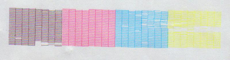

Hi everybody,
I wanted to ask you about your opinion. I have been doing some nozzle cleaning, head wash and custody wash overnight for about a week and this is a test print I get. There has been some improvement on a cyan head, but not on the other print heads. I was thinking of filling all the cartridges with the flush fluid ( acetone and butyl cellosolve ) and pumping whole content of all cartridges though all the heads. Is it a right thing to do? Could it help? Are there any other options to consider, before I go and buy new heads? Can black and magenta heads be used as they are, or they need to be replaced as well?
Thank you for your input.

Eeeek....those are not pretty. You can do the flush from the cartridges....might help. Mind me asking...how did they get that way?
MikePro
flushing won't cure that... you should be looking at your yellow head (and possibly a part of the cyan head) for a scratch across the nozzles. In that case, you need at least a new yellow head. I'm guessing cyan as well because it appears that the displacement carries from one pattern into the other in the same path.
(my money's on the paper cutting blade coming loose and falling out of its holder, then getting pinched as the carriage traveled by...spearing your printheads)
you're magenta and black heads look great, i wouldn't worry about a couple of blocked nozzles here or there.
at least an answer to your other question, yes you can do a headwash with cleaning cartridges full of homebrew acetone/butylcellusolve mix.
On the other hand, filling old ink cartridges with cleaner? idk, i wouldn't recommend it since you're watering down the debris/crusty ink and then shoving it through your printheads (think blood clots, ink clots). my printer came with a set of cleaning cartridges with the blank chips meant for headwashing, and I've just been refilling them on my own for the last few years.
I moved the carriage with heads to the most left side and inspected the print heads, but I didn't see any scratches. I must admit, that it is hard to see there, so I might overlook some damage. If I remove the head from the carriage, do I need to do re-alignment after I install it back?
MikePro
usually, yes, you would need alignment after reinstalling a printhead but that can wait until after you've solved your printhead problem. test prints don't require perfect alignment.

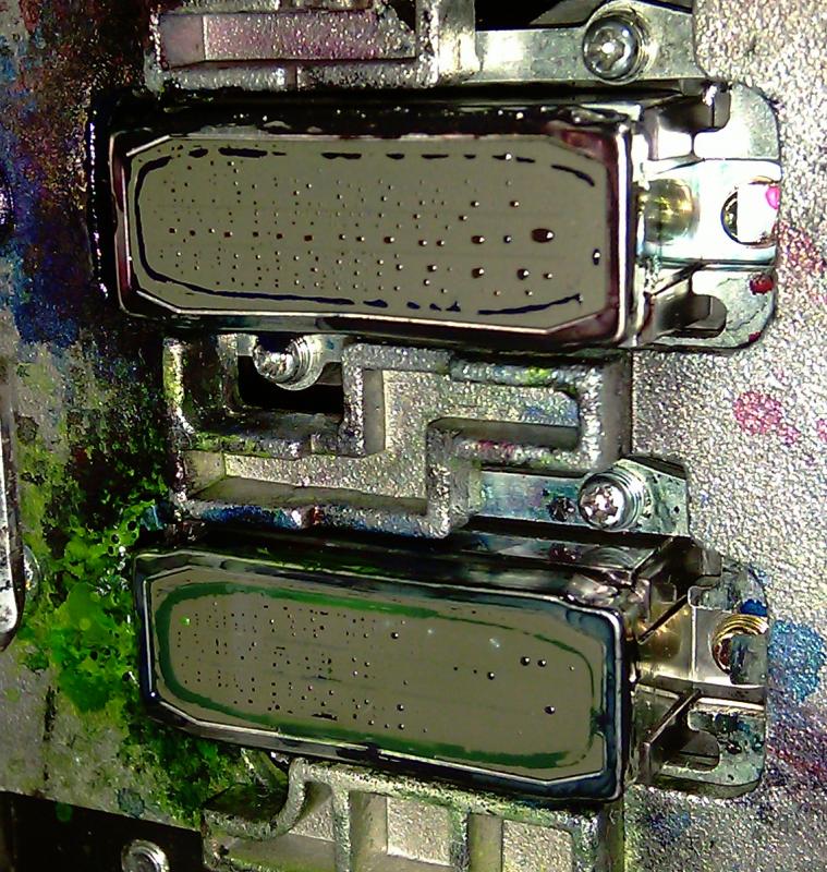

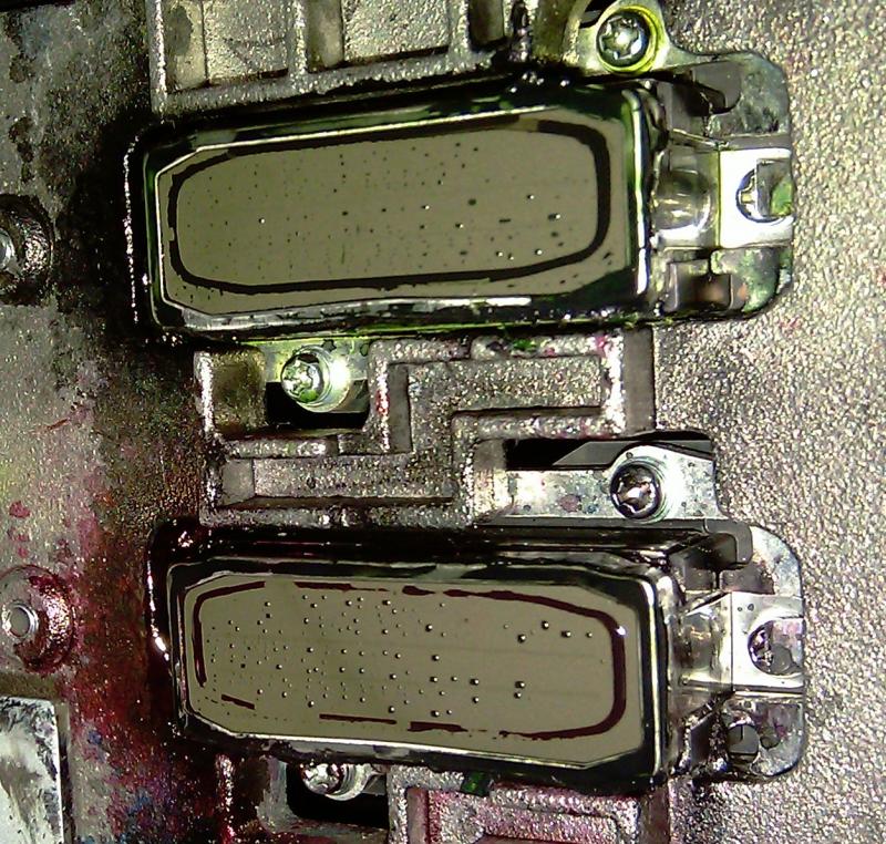

robsonr
Tonight I again checked the heads and I cannot see any scratches/damage on them. Pictures are attached. I'm going to try take them out this weekend and try what Robert M suggested.

MikePro
new wiper blade and a good cleaning, at the very least.
hard to make out from the photo, and under all the ink, but it wasn't as clear of a scratch as I expected it to be.
regardless, clean those heads!
4R Graphics
Hard to see if there are any scratches in a photo but they look ok to me.
