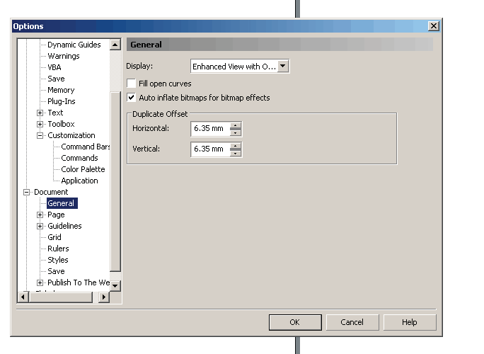

I'm using X3, but for your sake, am hoping this is available for 12...
Go to tools/options/document/general, and check "fill open curves".
As per attachment.

Its in the Options dialog under the document>general settings.
