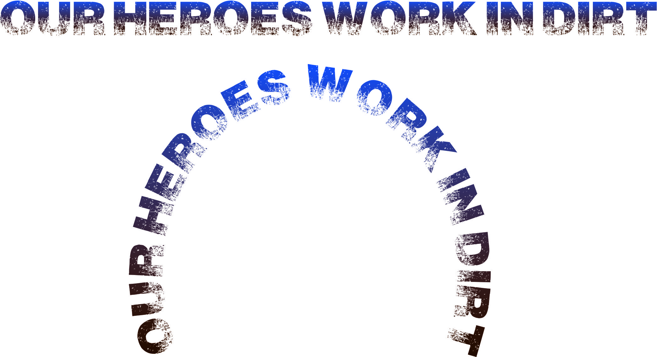

So I have this decal to do. They want words faded from blue to brown(top to bottom of each letter) and then arched.
I add the fade, fit text to the proper path, and then the fading changes. Instead of each individual letter fading from top to bottom, it uses the whole line collectively.
Is there a way to bypass this?
In the picture I posted, the top line is how I want it. The second line is after it changes.

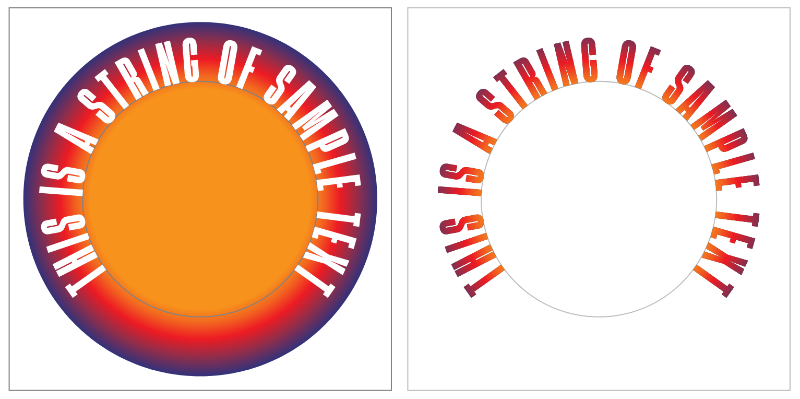

Make an ellipse big enough to contain the text that also matches up with the text arc. Fill the ellipse with a radial fill. Then powerclip it to the arched text. Problem solved.
