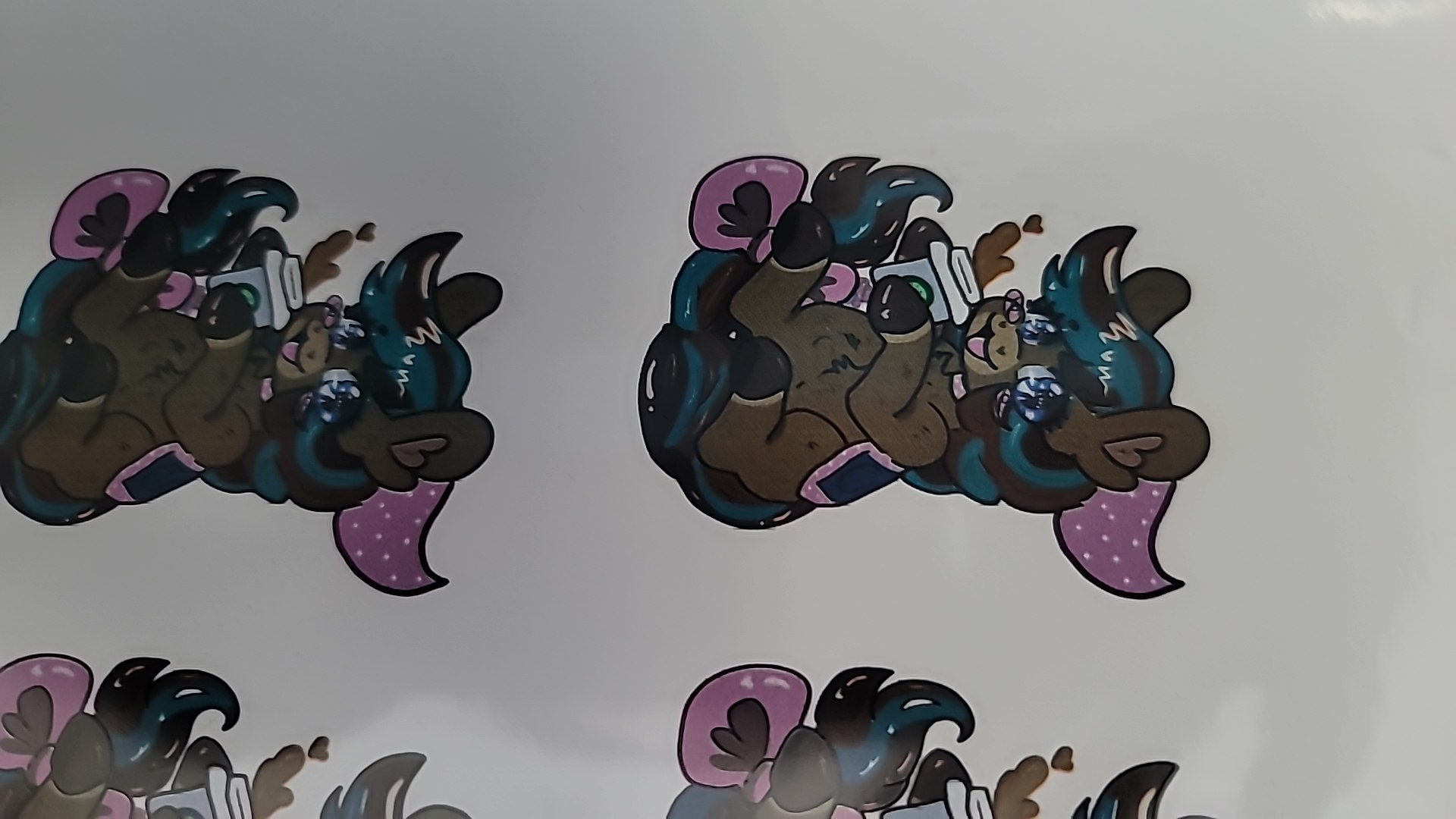

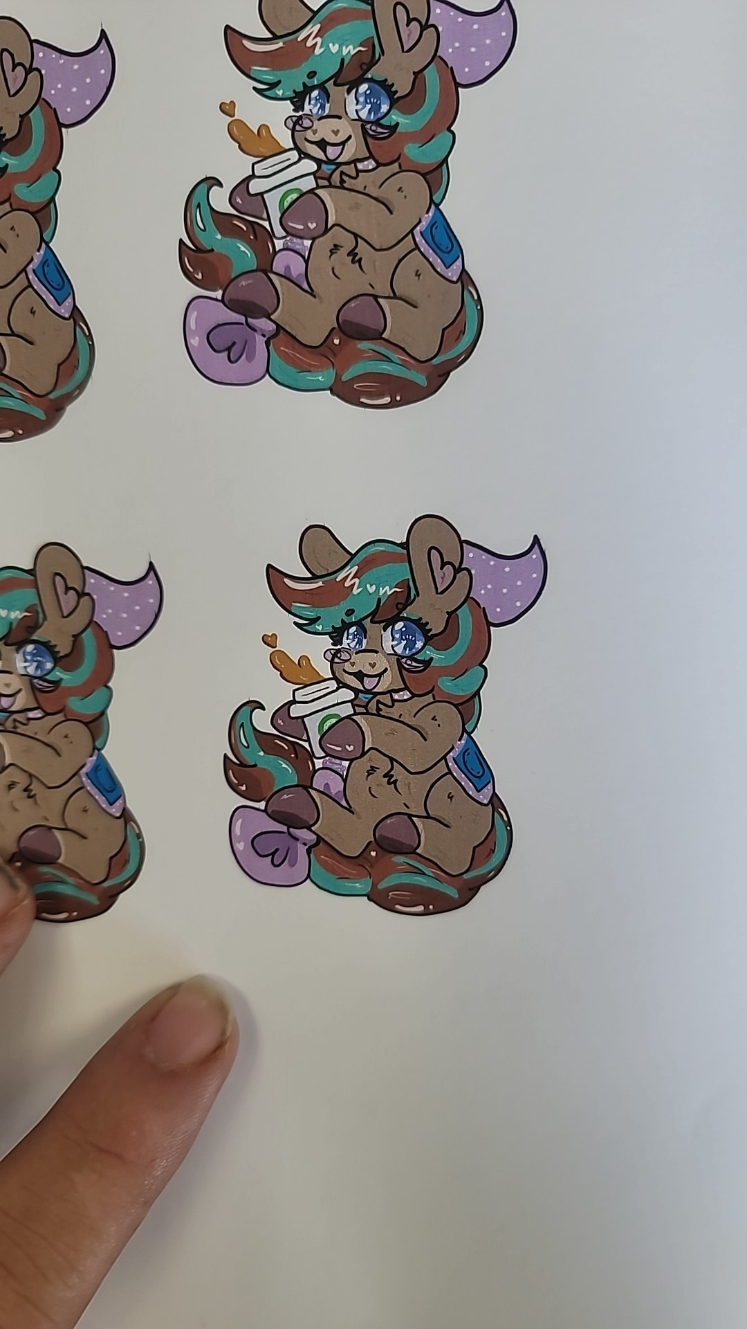

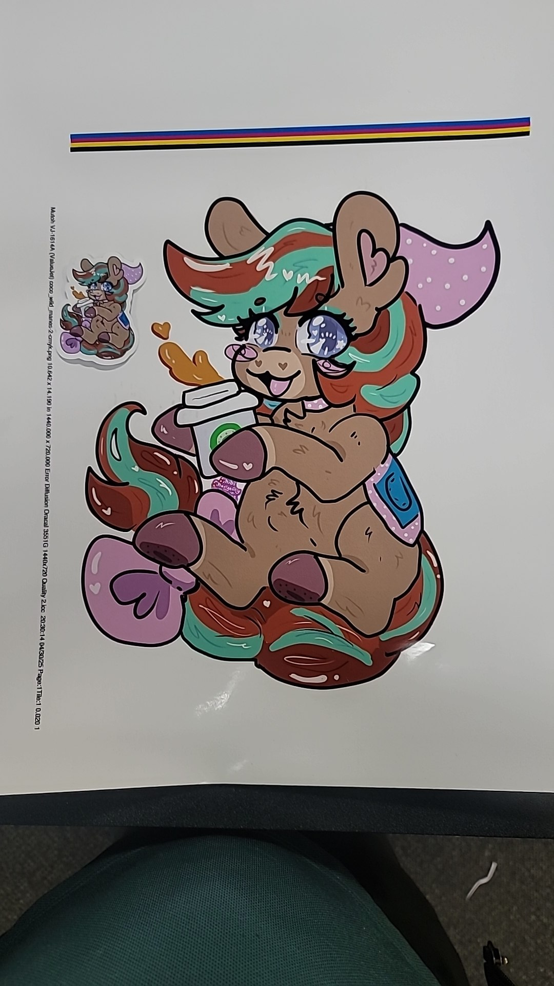

i'm hoping someone can help me with something I feel like I'm going crazy I have a sticker I am working on for a customer if I print it on my mutoh vj-1614 it comes out way to dark if I print it on my canon ta-30 it cines out right I am printing to both printers using the same CMYK file here is the results I have tried with and without color correction on the 1614. any tips or advice would be great Thanks Yonu
1614 print
TA-30 Print
Brian Tickenoff
When I see something like that, I check to see if one of my operators pushed the backlit button (double ink). I don't know if either one of your units has something similar, or if that's controlled by the rip.
