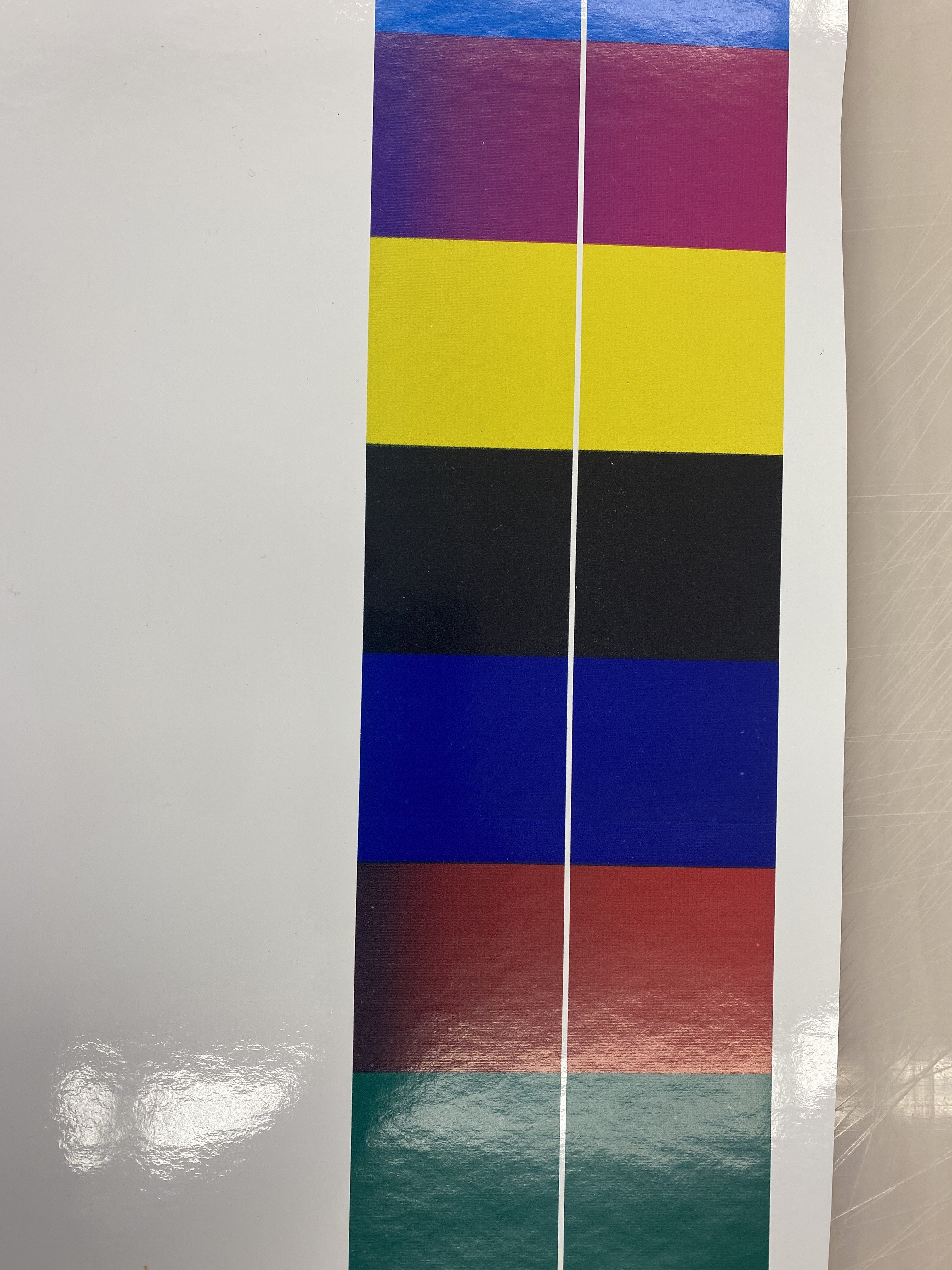

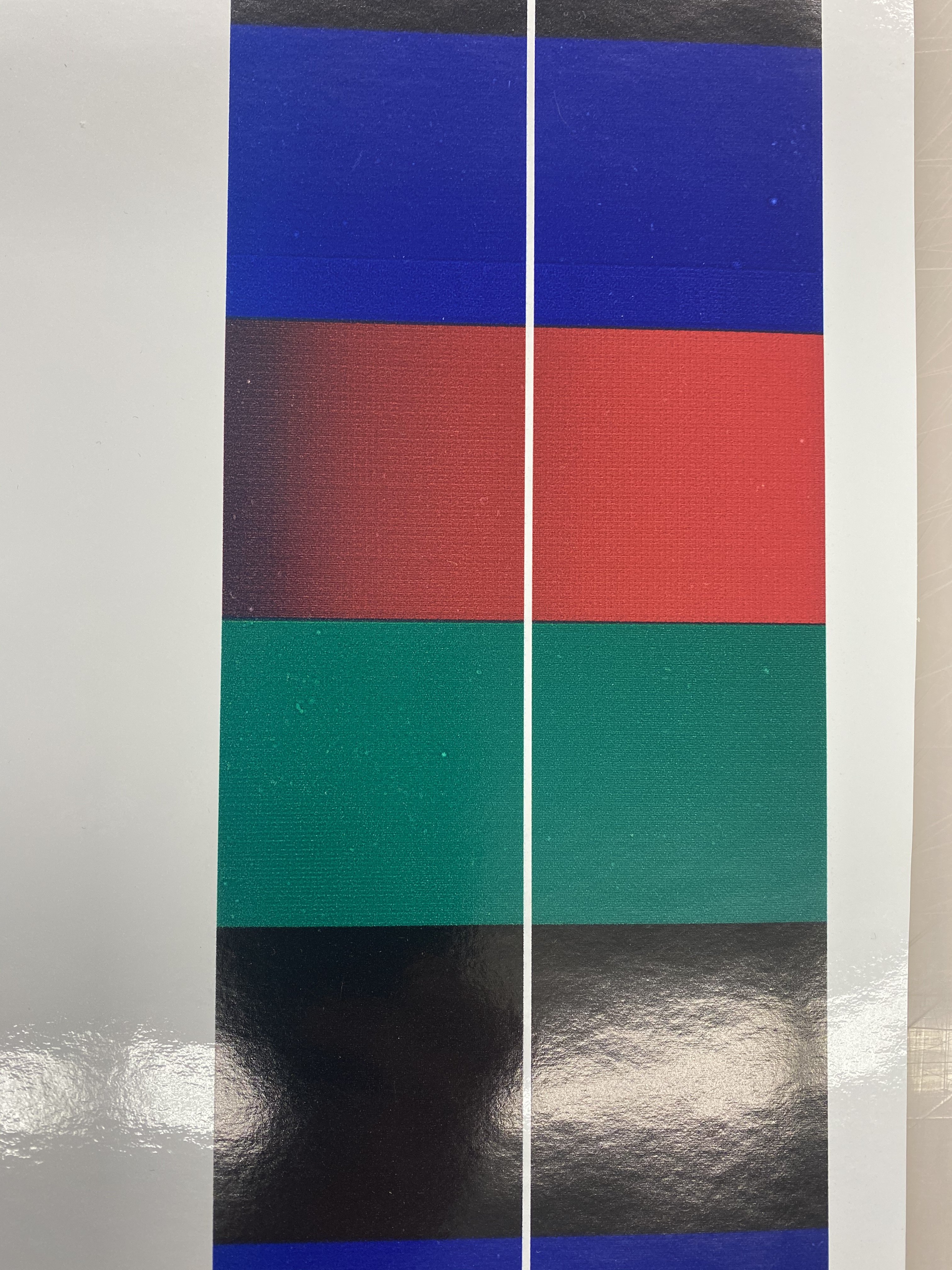

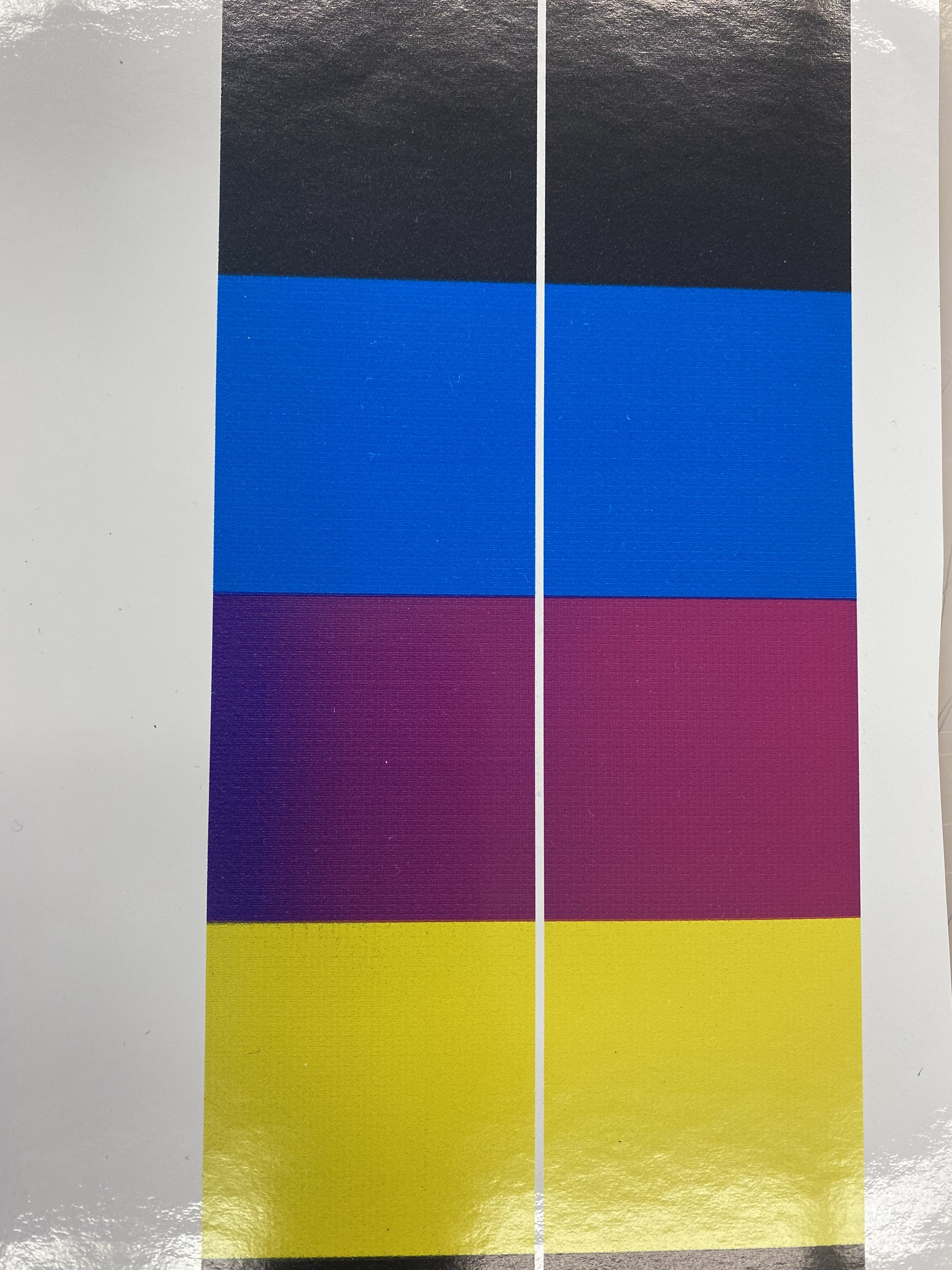

Hello I have a Mimaki CJV 30-130 and when starting to print for the day I notice that they test pattern I print the Cyan bleeds into the Magenta after not printing for an hour. Then I get print a test pattern to clear it out and everything works fine until it sits. Anyone know what is the cause of this.
Thanks

You should do a test draw at the beginning of the day and see where the cross contamination is. It could be a bad cap. Check for any swelling of the inner area of the cap where it might be touching the bottom of the head, causing ink wicking from one channel to another. Please post a pic of the test draw so we can help you diagnose your problem.
