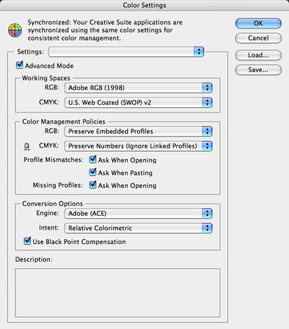

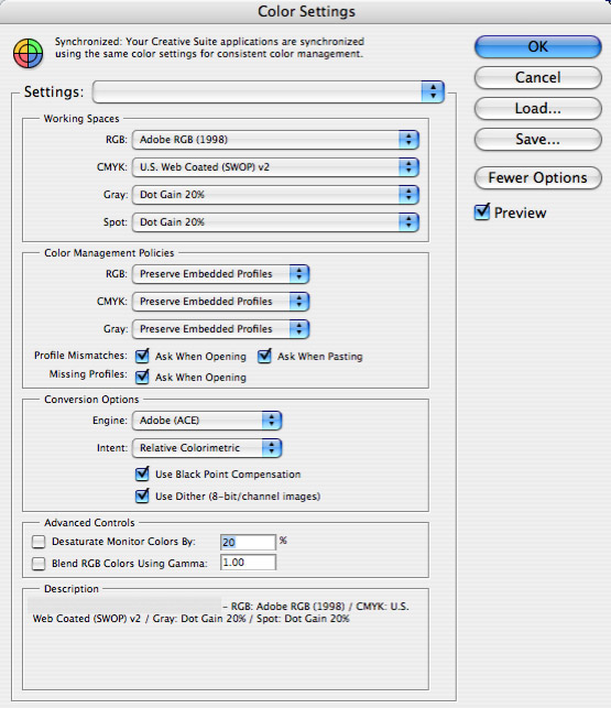

Here are my color settings.
This is the Illustrator one.
