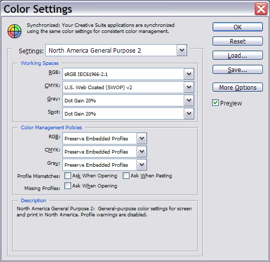

Yes. The problem is with the default color profiles you have setup.
Look under Edit > Color Settings at what workspace you are defaulting to. Mine are set as shown in the attachment and I have no problems such as you are describing.

I had that problem with two different new monitors. What you need to do is to assign a different workspace profile to the monitor than it's manufacturer thinks is what you will like.
