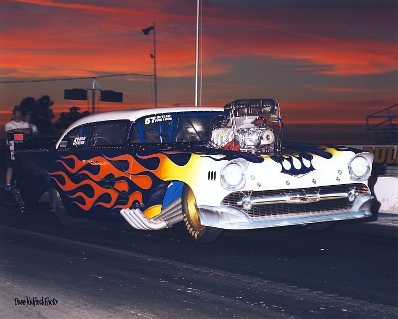

Favorite job ever done on my PC-600 was the grill on this race car, not bad for a printer that everyone says can't do nothing but small spot color decals. :thumb:
