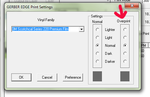

If you make the duracoat on overprint, on that menu it has an option to make the overprint light.
Marlene
You may need to check the settings so it knows the duracoat is the overprint. I am not sure what or where you would need to do that.

mmmm..im not able to find that option..as u can see Abrasion Guard=(my duracoat) is set to O=Overprint and menu as you can see here...
On the other hand the colours different menu...
mmmm i dont know.... maybe the solution is to set everything to light in settings menu but id like to print colours in normal and Duracoat UV in light....
