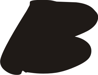

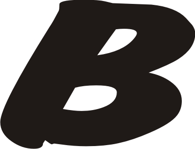

I bet this is what's happening. When you combine the centers in the image (see attachment 1), they go away, right? You want it like attachment 2, correct?
Select the nodes for the centers, reverse curve direction (its a node editing tool if you have node editing toolbar at the top of your screen, see image 3), then combine with outside object.
Seems X3 has issues with this, and it confused me for about 3 weeks before I found that it does this weird thing when you combine elements on top of one another and when they are reversed for their paths.
