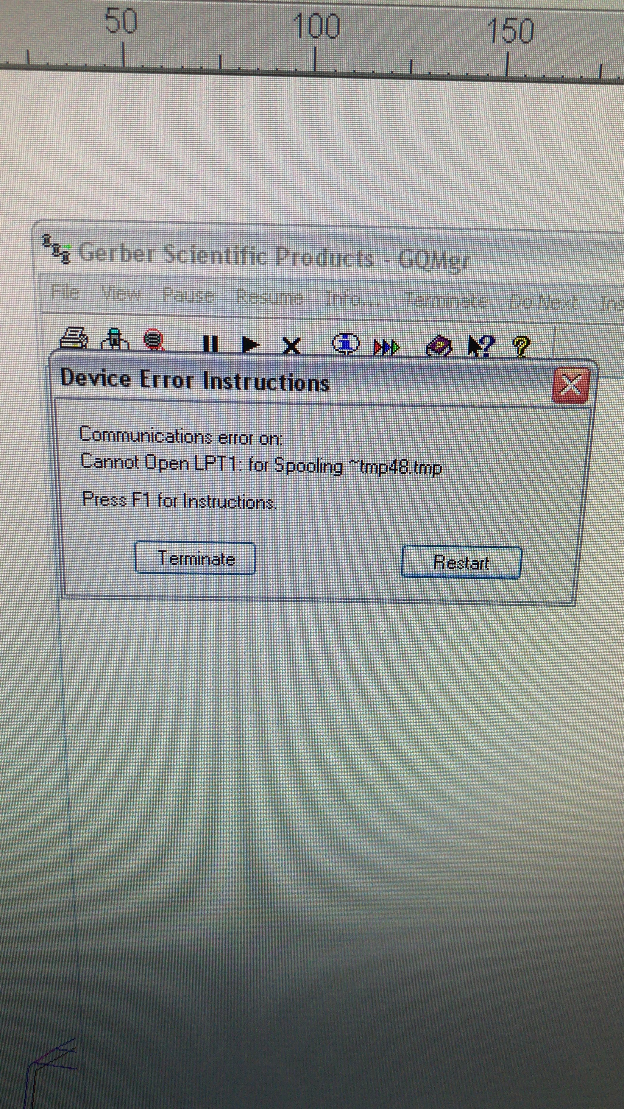

Hey guys,
I’m having issues with my edge 2. Now I’ve had the comma error message before, and I switched cables and it fixed the problem. I’ve tried 4 different cables now and still having the issue. The issue happens every time I’ve put the first foil down, it comes up with the error. I know I can try a new cable from Gerber but spandex don’t have them in stock. Is there anything else I can try? Been running this edge fine, then today all of a sudden it’s playing up.
Thanks,
Lew

Hey guys,
Thanks,
Lew

Lew Hands
Ok so since I posted this, I get the comms error after the first colour of say an 8 colour job, then I put that colour to the back and re run the job it runs fine, and this seems to happen every time. Also every time I do a job on clear vinyl, I have no problems! So I'm assuming for whatever reason, there's something wrong when I'm printing on the preset white vinyl, anybody know why this is?!
Lew

Thanks for the reply.
Its a windows xp pc, which was running the edge for 2 years with no issues. I just moved premises, set the edge up temporarily to print a couple jobs I needed to get out, then set the edge up in its new home, it printed fine for a couple days and then this all started.
Im leaning towards something in the edge, I've tried unplugging etc and restarting. I think ill try uninstalling omega and reinstalling? Just seems strange how when I print on the standard selected white vinyl I get problems, but not on the translucent vinyl?!
Lew]
