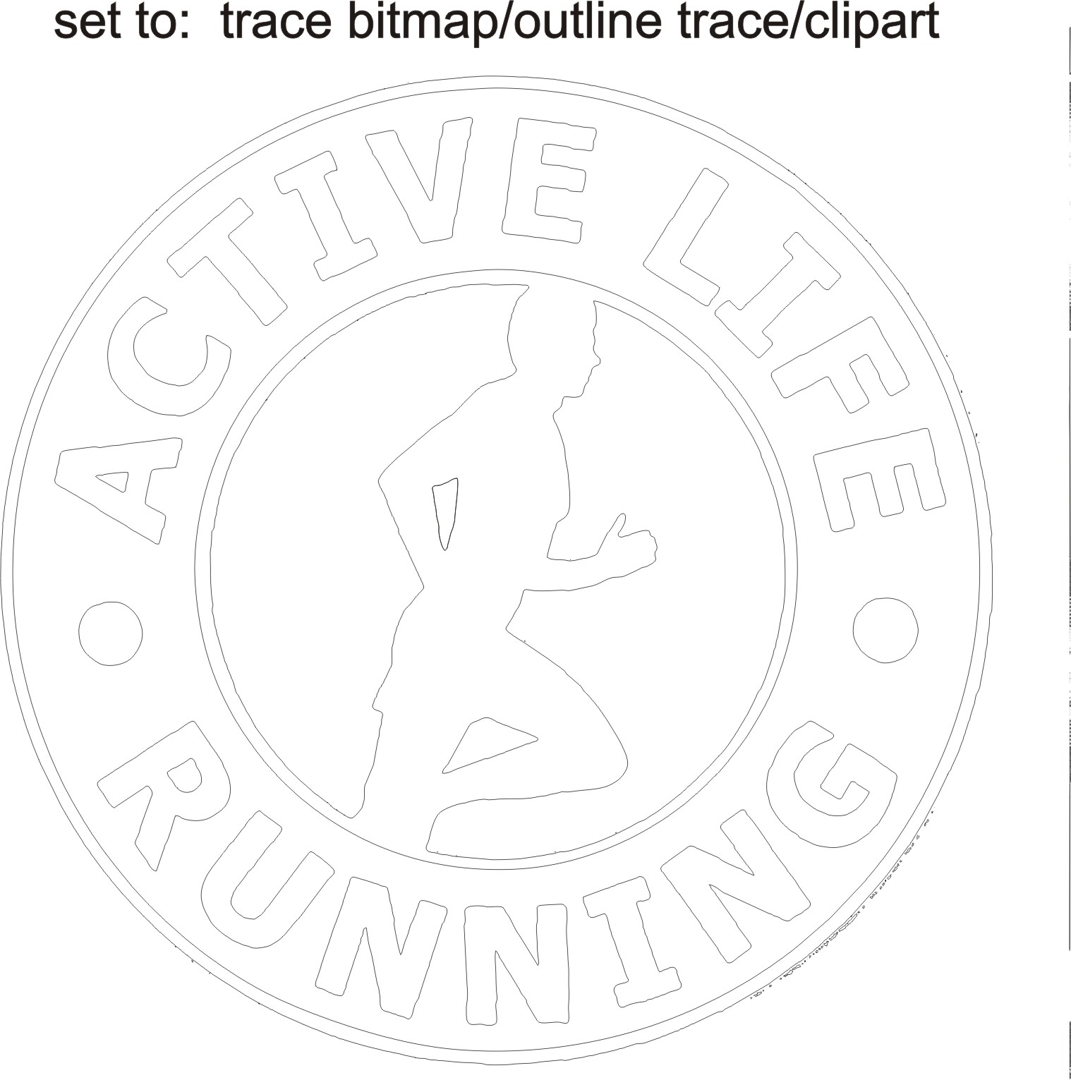

This is what I got in a few minutes using coreldraw x8. I did convert the png file to a greyscale bitmap, then after adjusting the contrast I converted to black and white before tracing. I wasn't saying that Graphic Tracer won't do a better job, and maybe get results quicker, I just think Coreldraw gets me vectors better than what I saw in the video. I also wouldn't call myself "someone who knows what they are doing with Corel". Daily I'm shown how little I really know....

I can see that the bitmap has been up-sampled a great deal before the trace in Corel.
The video (which I have made) was traced from the bitmap 'as is' in all programs.
I think, however that Corel Trace has a bug that messes up the settings for Details when I reduced the number of colors, so the results could possibly be a bit better.

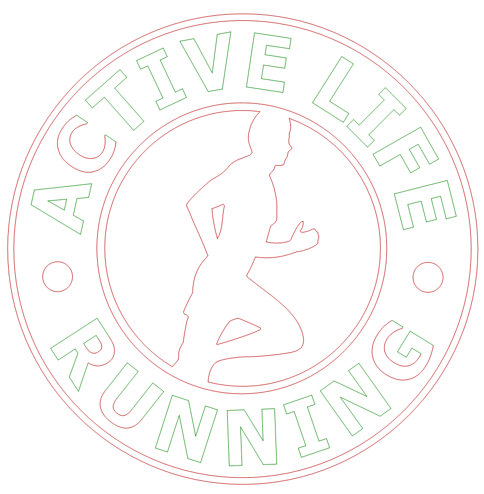

Here is the outline from Graphic Tracer, and as as stated in the video the texts have been replaced with the correct font automatically by the tools in the program.
Getting this result in Graphic Tracer takes about 4 minutes.
Lines are green and curves are red in Graphic Tracer.
BTW, I have tried to duplicate your trace in Corel, but can't get the logo appear correctly by simply adjusting the contrast. How did you do that?

As I said in my post above I am no expert, and I'm pretty sure there are many methods of reproducing logo designs I'm unaware of. I just converted the design to greyscale at 300 dpi, then fiddled with the contrast, darkness and intensity till the components are isolated from each other enough to get a black and white image I can trace. I would still need to find the font and insert it on a curve before my method would produce something I could print or cut in vinyl. If Graphic Tracer automates that process then that's a big time reducer they can be proud of.
