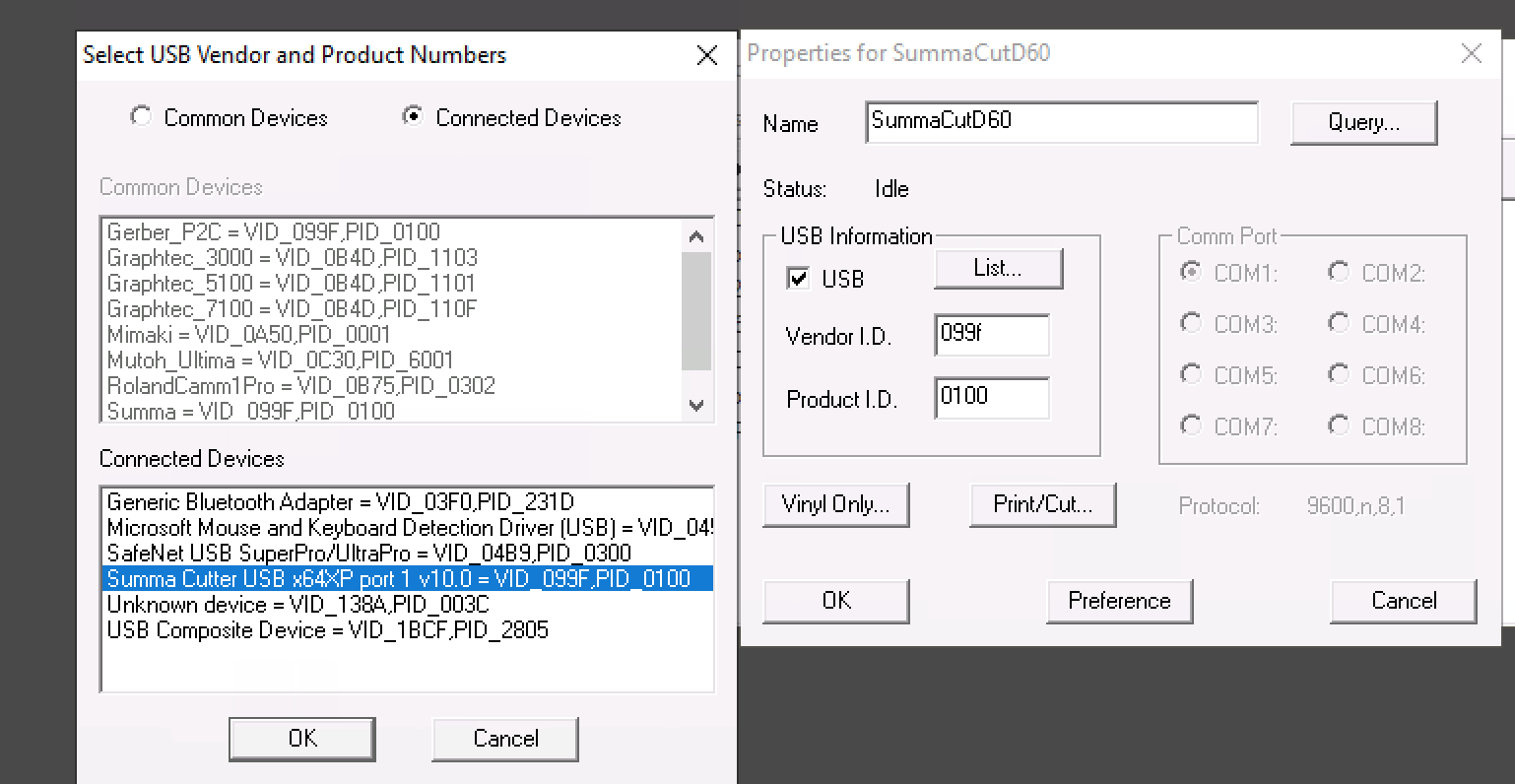

Have you selected the right USD device? Summa VendorID: 099f, and ProductID: 0100. GerberQM should find it automatically. Can choose manually from the list of Connected Devices as well.
