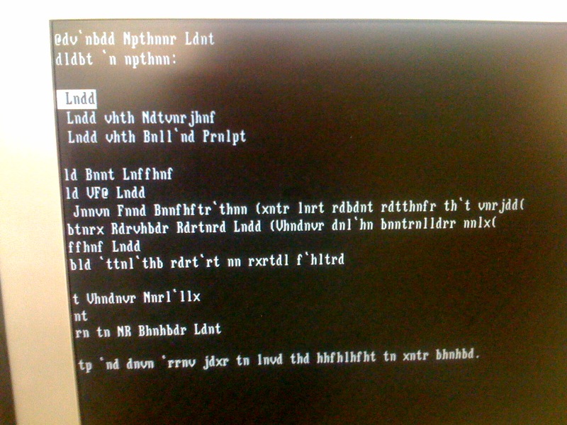

So my salesman brings in his computer and tells me it doesn't work, the screen just goes black when Windows loads. I tell him I'll take a look. I figure I just need to install a new video driver, should be simple...
Well this is where the quandary comes in. When I start the computer I hold down the F8 key so I can start into Safe Mode, but when the screen pops up for me to select safe mode it's just a bunch of random letters, like it's a different language or something.
Now I know that the first option is Safe Mode so I'm able to select it and boot into Windows but I was wondering if anyone knew what would cause this jumbled mess of letters???

Had the same problem a--long long time ago but it was ace of spades, clubs, happy faces,etc... and you can bet what it was. A virus. I ended up taking it into a computer geek store and they did a system boot off another computer. I wouldn't try it using your though!
IF you are not needing any of the files on the hard drive. Your best bet would be to format the hard drive and reinstall the O/S and have a fresh start :)

The question was :Well this is where the quandary comes in. When I start the computer I hold down the F8 key so I can start into Safe Mode, but when the screen pops up for me to select safe mode it's just a bunch of random letters, like it's a different language or something."
IMHO it sounds like it could be a bios problem. Only because it happens before Windows even opens.
cgsigns_jamie
Actually that screen I mentioned is a part of windows, It's the "advanced boot menu" or something like that.. As far as I can tell the bios is okay.

Try re-booting from a safe boot disc, and then try a decent anti-virus program like AVG.
If that doesn't fix it, format and re-install.

That is a new one for me...
- Once you get into Safe Mode, can you run an anti-virus scan?
- Is the text jumbled in the POST portion of the BIOS?
- How about in Safe Mode, anything abnormal there?
Before a clean install, I would probably attempt a "Repair" install and then a complete virus/malware scan.
- link (Microsoft)
Or you can Google "XP Repair Install" for more info on this procedure.
The screen that you are on is definitely a Windows (not BIOS) screen, but it does rely on the video card at this point. Bad video hardware is a possibility. A quick Google search found a similar issue in Aug '08 on a laptop, but no resolution.

Once I get into safe mode all is normal. I did run a virus scan and it came back clean. It was an updated version of Norton with latest definitions.
I assumed the only thing wrong was the video driver, maybe the hardware. Never expected a virus.
He told me he turned the computer on Wednesday morning then left it on for 2 days and when he came back on Friday the monitor was blank and wouldn't come on. He then restarted it and he had video until it got past the Windows loading screen, with the green progress bar, then it went black again. I assumed it was something wrong with the video driver. I didn't think the hardware was an issue since it had video all the up until windows loaded.
It's an HP Media Center PC so I went to HP's site and downloaded the video driver they have on their site and I'm going to load them when I get back to the office tomorrow morning. I just wanted to know if anyone knew why the text was all jumbled on the advanced boot menu. Now that people are telling me it looks like a virus I'm thinking of reinstalling windows.

Jamie, my media center at home is doing the same thing. But it freezes at the window you posted and I can not do anything. Also has a jumble of letters. The media centers do have a recovery option on the first screen. It runs a PC recovery and makes the computer like it came out of the box. Not working on mine. I have recovery disks that are not recognized by the computer HP tells me I need to have something flashed?? It is going back to Best Buy tomorrow.

Boot menu problems are not virii in my experience. IT is a failure of some code.. So, I do not believe this is a virus at all. Ive observed this several times before. EAch had its own reason.
