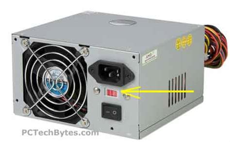

Modern power supplies can be set up for either 110 or 220 via a switch somewhere on the supply like the pic shows. Find it, make sure it's set to 110 first, then you can use any std power cord. Again, make sure it's set to 110 first, don't just flip the switch and go, some of the imports will have the switch set to 110 already, but include the wrong cable. I don't like Newegg, they're kind of like every other major site where they have multiple retailers & vendors listing on their site, so much of it doesn't come right from them which causes service issues if something isn't correct. I usually go through TigerDirect, everything they sell comes off their shelves. Can't attest to their customer service because I've never needed it, everything I've gotten from them over the last 20+ years has worked as expected. Last system I ordered from them was about a year ago, plugged it in, it fired right up, and it's been on since with zero issues.

There is no switch on the back of my tower like that. Here's a link to the unit I purchased: https://www.newegg.com/dell-optiplex-7090-student-home-office/p/1VK-0001-68ZX5
Thought it met all my requirements...me and technology never seem to hit it off.
If it doesn't have a switch it's most likely auto-voltage sensing. Lots of newer stuff is like that, they did away with the switches and integrated a sensor so when you plug it in it sets the value automatically.

IF THE POWER SUPPLY says 110V ~ 220V and has no switch it is AUTOSENSING
if it only lists one voltage that is all it will work on
plugging a 220 v into a 110 v outlet is not going to do any damage if it is only plugged in, until you realize it doesnt work
plugging a 110 v into a 220 v outlet will fill the room with smoke and probably make a high pitched squeal
