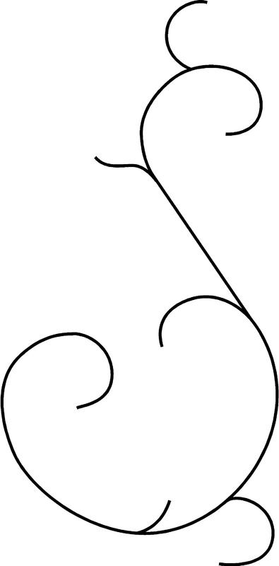

I used to cut designs out of sandblast mask for a client who would mold them into a concrete counter top. And then he would remove the mask, and pour in another colored substance. And have kind of an inlay-ed look.

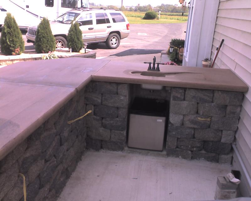

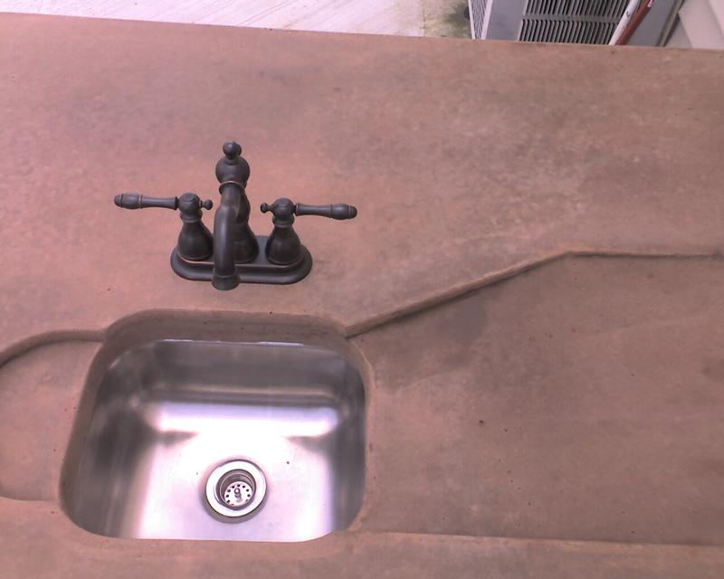

Here's one I did at home several years ago. It's held up very well actually. Just regular 4000 psi concrete with stain mixed in. 3/8" rebar welded up into a grid of about 8" x 8". I felt that was necessary for the big overhangs. I am about 10 years into it with no cracks.. PA winters.
I have a pretty decent concrete vibrator but even if didn't regularly need one, I'd buy the harbor freight one. Your savings in doing it yourself will easily pay for it. I clamped the vibrating head to one of our work benches... shakes the whole table just the right amount during the pour.
I did the bullhose edge forms by pushing strips of blue foam insulation through a table saw on a diagonal to let the blade kind of "scallop" the profile out. BE CAREFUL with the table saw stuff... method was a little unorthodox but the effect was a big hit.

Andy D
Nice! Did you do it via a female mold? I would think you would have to had to with the sink.
John L
Yes, I poured it into a form made from 3/4" Melamine sheet (with the foam put in the edges). Poured upside down to take advantage of the smooth melamine sheet face. You have to let it cure a couple days at least before taking the form off of it and flipping it over when doing it this way but I never polished anything after it was done... that smoothness was from the form. The sink and faucet holes were just multiple layers of melamine with thin shipping foam wrapped around it so it would release.
You have lots of edge options nowadays... no need to wing it like I did.
