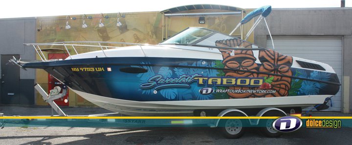

180c v3 with 8518 gloss overlam. Its the wall behind the boat. Its in extreme sun all day and has seen some brutal winters. It stayed up for 3 years till we moved and removed it. It showed no signs of adhesion failure an would have stayed up another 3 years. It basically was an experiment to answer the question you have now. We were very satisfied.

Man that boat wrap is sweeeeet!!!
