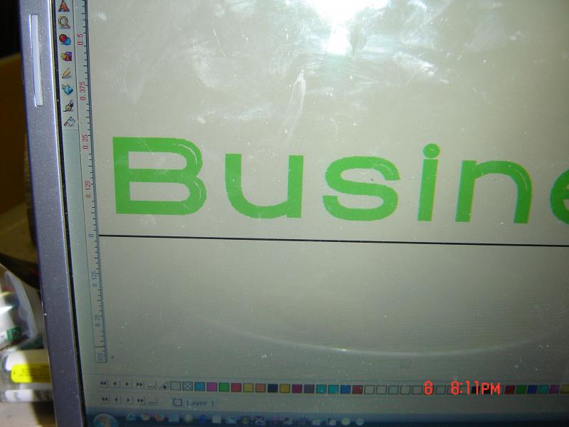

I'm kind of getting drug through the dirt by a designer. I run Versaworks 4 and design in Signlab 8 or CorelDraw X3 and print on a new Roland Sp300i VersaCamm(6 moths new). I keep getting these design eps or pdf files from the designer. I managed to get one to print but it printed some glitches, lines not seen in the design software but apparent in the eps file in Corel,or the Versaworks rip and on the print. The customer wants the printing done right,

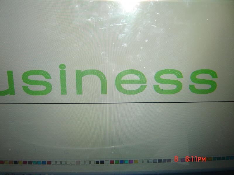

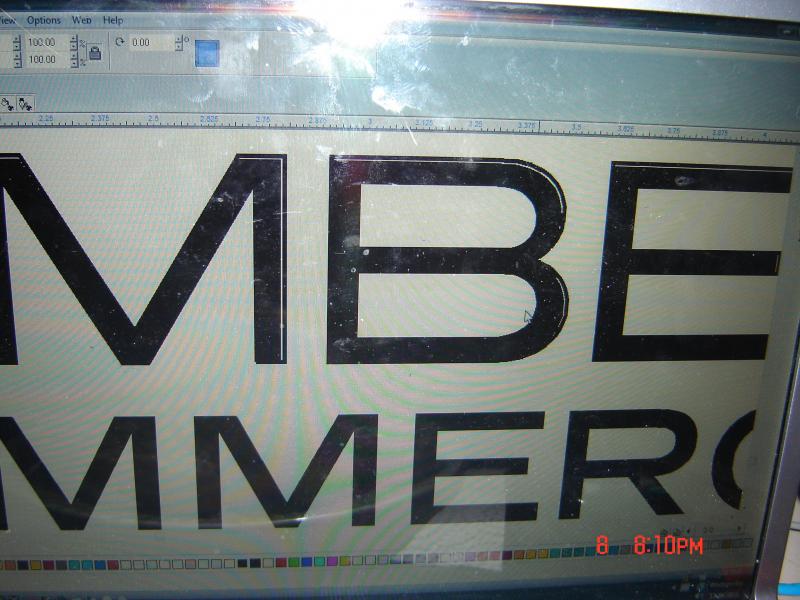

here's a few pics of whats on my screen

So, assuming those slivers of white are not supposed to be there... are those letters built with multiple lines or with strokes instead of fills?
CentralSigns
That was the view in Signlab 8 and same as what I see on Versaworks screen. The small sliver lines are not supposed to be there, but are visible in the screen shot. what I see up close is a edge on the letter that makes it look 3D. The designer doesn't see the lines on his screen, and as a result says they do not exist. He also had another designer look in illy and of course there are no lines. they refuse to look at SignLab 8 or Versaworks without a consult fee payable by me. Any ideas
