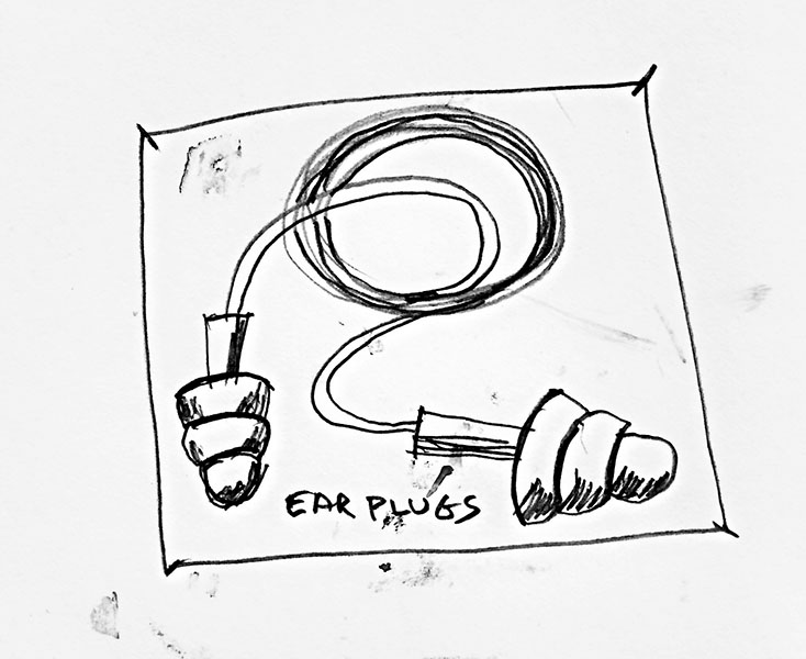

We had to build a separate room for the router to keep the dust contained, we spent quite a bit of time and money on dust extraction and noise abaitment. to operate i had to wear earplugs AND earmuffs. There was quite a bit of work in keeping the noise dust and waste under control. We sold it 10 years later
