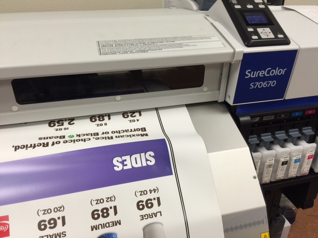

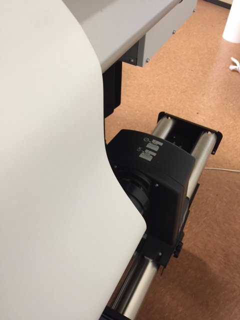

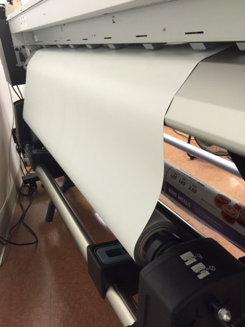

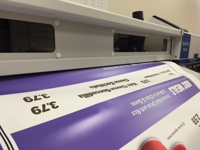

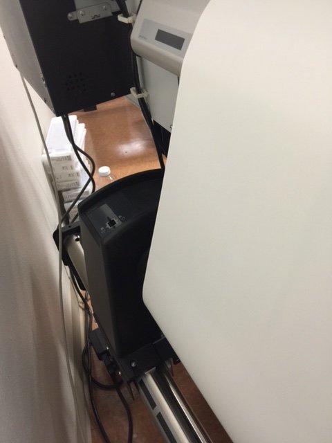

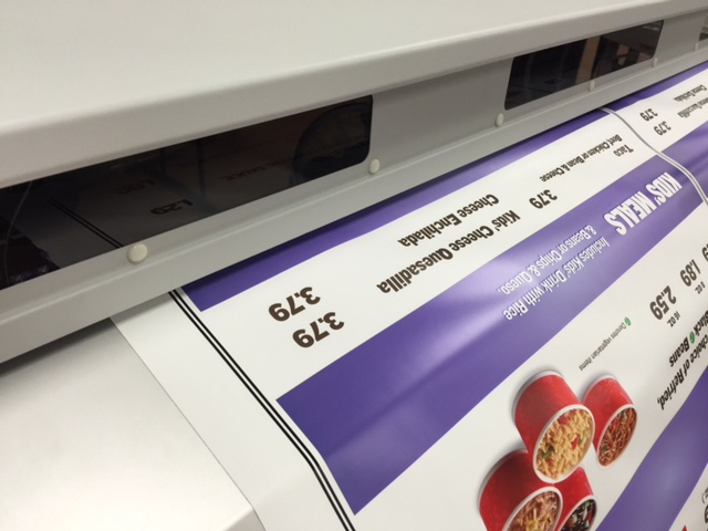

I am running a job and I keep having the same issue - It seems like the take up reel is not rolling up evenly. After the printer prints for 10-15 minutes I start to have issues with the media ( see photos). i have tried every thing I can think of to make it work but no luck. Anyone have this issue before? I have never had this happen. Is it possible that the roll is wound crooked?
Printer: Eco Solvent Epson S70670
Media: Xcel Magnetic Receptive
Roll: 54"x150'
Heater settings: 38, 38, 40

looks like it's feeding crooked, from the back on side is tight, and the other side has lots of slack. I see some prints on the take up reel, was it used for this set?
crooked media a lot of times is from how it's loaded, if one core end is in further than the other, the roll will be leaning down on one side. It's hard to tell from the pictures if thats an issue here.
Dionysus
Get yourself a fabric tape measure (a tailor's tape measure) about 10 feet long, and measure off both sides of the input roller to the take up (in a loop fashion). Your input roll is not square causing everything to skew. Get it down to the mm and you'll be right as rain.

You need to play with your media tension on the Epson for that material.
It's in the Advanced Settings under customize.
I believe it's standard at 15 or so, try to increase it and see if it helps. Goes up to 40 I believe.

Run a slip sheet under the material, magnet can get a static charge and stick real bad. Then check your heat.
The weight of the magnet should drop naturally so your tension should be fine, you may just need to not use the pickup roll at all. I’ve printed thousands of magnet jobs and had to fight those same nuances
greysquirrel
Ahh s70 the original 30 50 70 were prone to this if your R2R has not been calibrated properly. Most times they were not. It does not show on all media, but this might be one of them.
Other item to check is the media profile that you created on the printer. You probably need a specific one due to weight. I raise head height while at it. But you may need to correct the feed tension.
