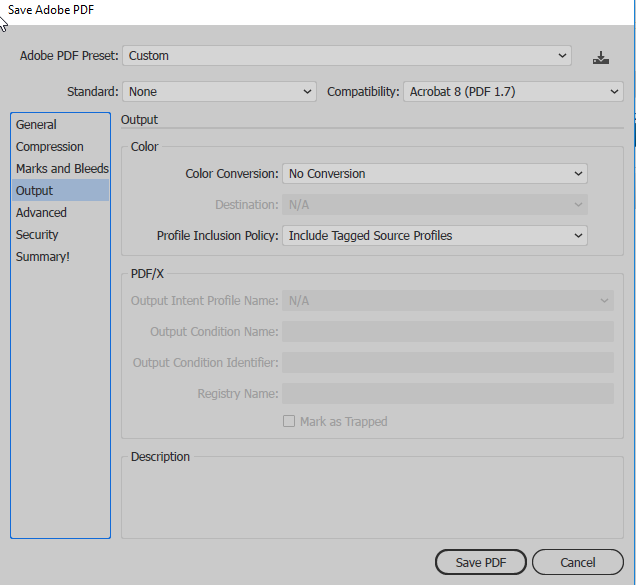

Ok so here i where i am at.

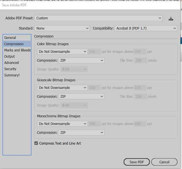

Opened my template in PS it is a 720 dpi file at a smaller scale. Created my design and saved it as a pdf. I turned off all the downscaling. Then i opened that file in Illustrator by going to File / open.
I created my cut path and did t scale anything. I saved the file as a PDF with no down scaling. My file is now 72 dpi before i scale it up to 1000% to make it full size?
I cannot use EPS as it doesnt embed the color profile so my colors change. I cannot use .ai as onyx doesnt recognise it. I cannot export as a .tiff out of AI b/c onyx doenst see the cut path labeled at cut contour from AI and will not cut the file..

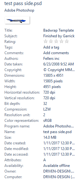

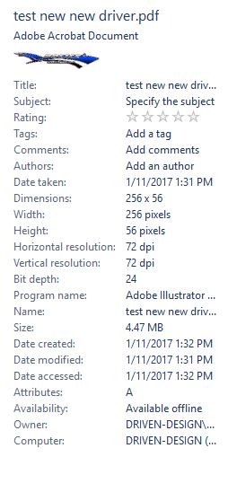

The file i am opening into AI is 720 dpi but the saved pdf is 72 dpi?
I have tried opening a blank AI file and then placing the file into the new ai file. Same outcome.
I have attached a few files. You will see one shows 720 dpi. Thats the file saved out of PS.
The one that shows 72 is saving out of AI.

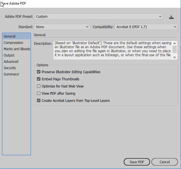

i have also attached images of the pdf settings as well.

Also PDF file from Ps is 124mb. Saved file in pdf from AI is 6.62mb
So i tried some different stuff.
My files coming out of PS are not even at 720 dpi. When i save a Tiff or a PSD file out of Ps they show 720. I can open it in onyx job manager and its shows 720 as well. So for some reason my files coming out of Ps in PDF are not staying 720
altereddezignz
Someone smarter than me take a look. This is a PSD file all created the same way.. The file is 720 dpi.

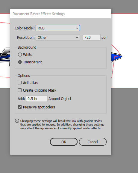

I need a pdf out of Illustrator but at same scaled size but keeping the same 720 dpi so i can scale up in onyx rip.

I have tried this a million times now, full scale and scaled down at 10%. Tried grouping all files to a folder in Ps and using a color overlay. Then saving that over lay as a jpeg, png and so on then using AI to create a vector and still get crappy lines.
Also tied the same ways with work paths and when i create the actual cut path from the " Dancing Ants" My lines move and are not as accurate as the Dancing ants?
