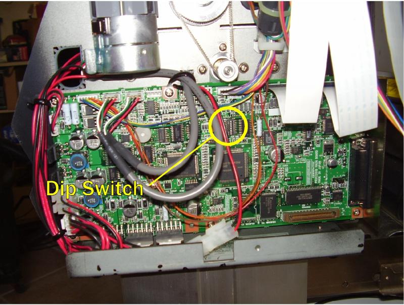

These are the settings on mine and verified on another members Q 100
Note you are reading 1 through 8 from the bottom up and looking at the dip switches head on, the "ON" position is to the left.
Hope this helps.

cmwyke
Thanks Bradster, it would appear that I was wrong in what my settings were, they are already set like yours. I guess that's not it.
