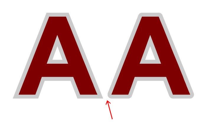

In my old ScanVec Inspire software I was able to choose either a sharp or rounded contour outline (as shown). Can the rounded type be done in X5? It seems like the only option is sharp.

Set your "contour" using the round outline. Then press Ctrl-Shift-Q and you will now have a vector shape of your outline. Then weld a copy of your original shape to the vector outline.
Colin

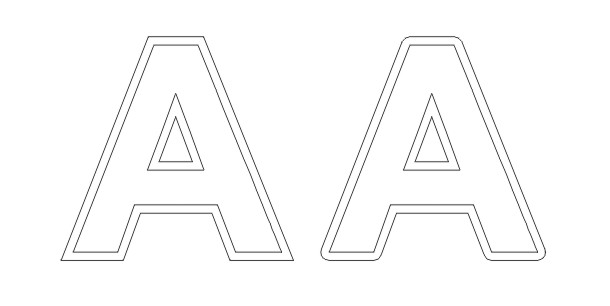

Yes, I was aware of that ability/method, but can the rounded contour be done with the "Contour" command (under the "Effects" menu)?
Using the method with the "Outline" as you've described requires a lot more steps & deleting to get the final desired result.

If you don't want to use a stroke to create the contours you can build your contour and then fillet the corners you want rounded.

Yes, I was aware of that ability/method, but can the rounded contour be done with the "Contour" command (under the "Effects" menu? Using the method with the "Outline" as you've described requires a lot more steps & deleting to get the final desired result.
No.
But I've come to realize that setting your Contour with the outline tool at first is way easier and quicker for the program and gives you much more flexibility re shape of nib and corner style, etc.
Once you hit Ctrl-Shift-Q, then copy/paste your original shape and then welding it to the (now) vector outline to fill it in (if necessary) really isn't that many steps at the end, especially for the amount of control it gives you at the beginning...

Here is what I do. There is a docker called "Fillet/Scallop/Chamfer". It's under "windows" -> "dockers". I leave that docker up on my screen because I use it a lot for all sorts of things.
Simply apply a fillet to your lettering or shape. It can even be a super small radius. THEN do your contour work. Presto rounded contours. The bad part is that you turn your text into curves when you do that. But personally, converting things to curves isn't usually a concern of mine.

Thanks Wayne, but on a complex contour, this is even more time consuming than the "Outline" method. I fail to see why Corel couldn't add this option to the "Contour" command (which hasn't changed in a decade).
Thanks, Joe -- I totally forgot that was there....
OR... you could apply the desired contour, break apart, then apply the fillet to the contour, leaving the text intact.
