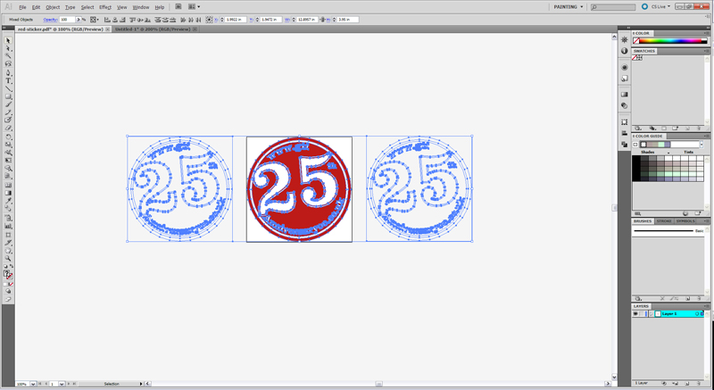

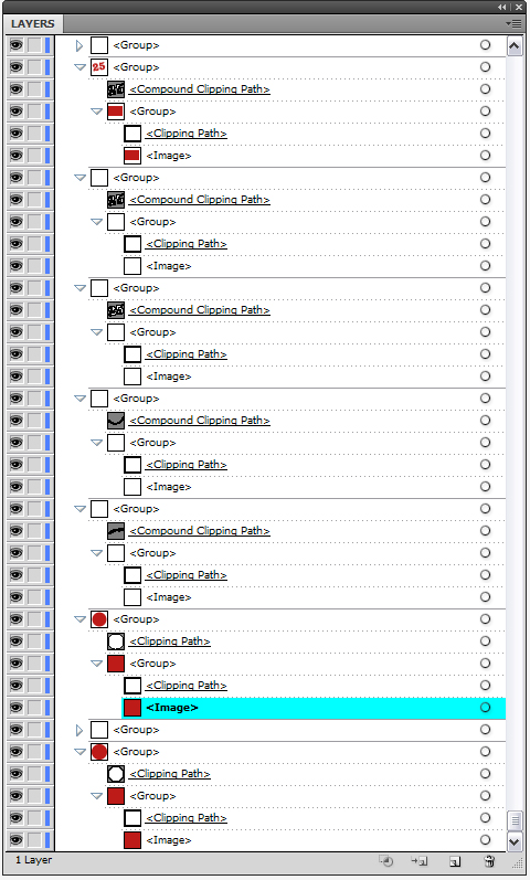

How is that? I just looked at it again....it is 3 circles with some text in it. Nothing complex about this at all. Pretty much ready to cut, except you may want to weld the number outlines to the inner white border. Other than, this is very simple.
In Illustrator I was able to separate a clipping mask and a second set of vectors hidden under the first. Here are screen shots with and without preview turned on.
In addition, the red color is not coming from a filled vector. Rather it is coming from one of three groups containing a red bitmap image.
