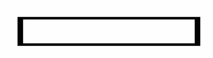

Here's where scale to object becomes problematic. Draw a rectangle with a "fat" outline and with scale to object on, now stretch or resize just the width of the rectangle. Notice how the outline doesn't stay consistent. That's why a macro was created to do a quick fix.

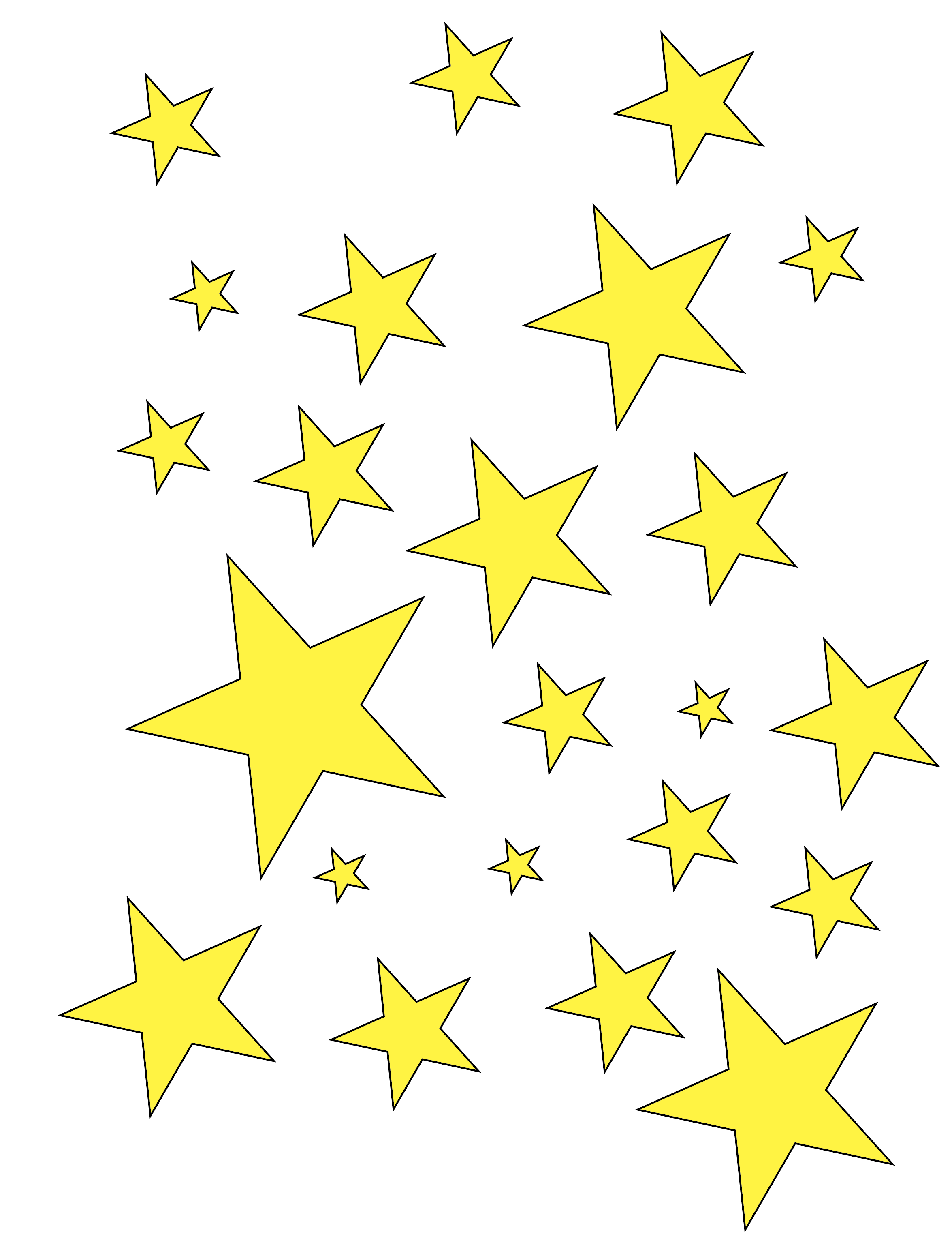

In illustrator I do this all the time. Let's say you have a certain shape that you create once and you then copy/paste/resize that object on the page. As you resize the shape you want the stroke width to remain the same for each object instead of the outline getting thicker or thinner every time you resize it

It does not have to be the same object. When I create something on a page and i want all the shapes to have the same stroke width I can create and then scale the object without the stroke width changing everytime I size it up or down
